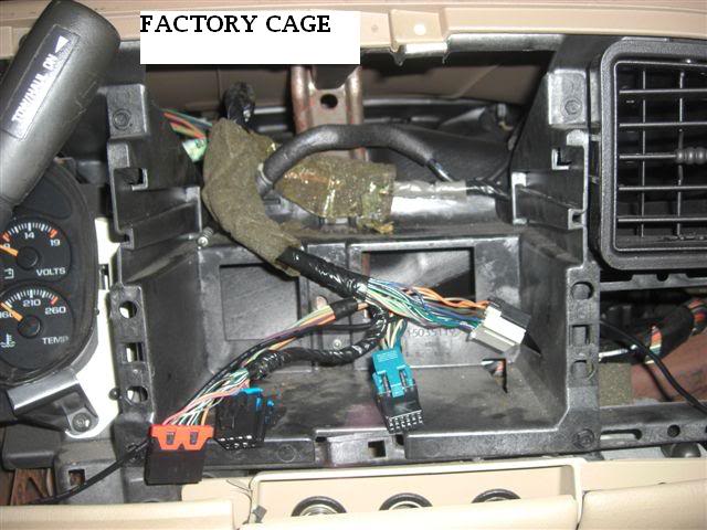

i just did mine. no pics of it. but its pretty easy. i removed the cage and slotted the holes with a round file so it would go down. and also cut the clips off the hvac unit and instead slotted the holes on that and used screw to hold it in. then used a dash kit for a 07-09 tahoe, cut the mounts off of it and made brackets out of metal strapping that bolt to the side of the deck, and also a piece screwed to the back to make it harder to steal and helps stabilize it in the dash. i didnt mess with the ashtray or power outlet door...i dont need ashtray and i can still plug stuff into the power outlet if i need to. took about an hour to get everything fitting right.

i didnt change the cage. i moved the cage down. ill take some pics of it installed.

friend used a 03+ cage on his over the weekend and still had to hack it up. use the cage you have and it will look better...

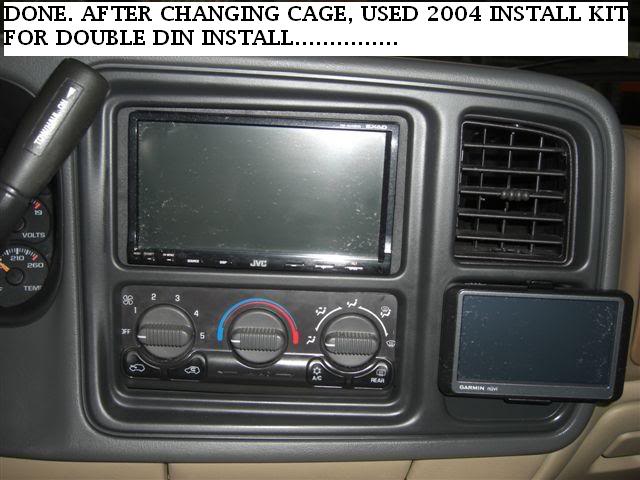

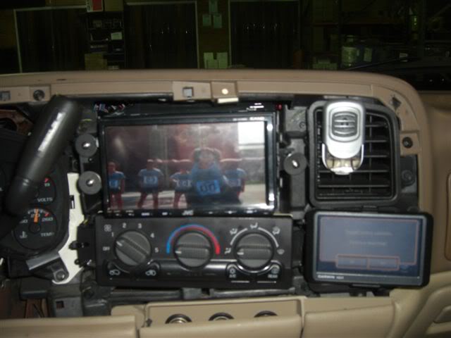

Finally got time to complete to DD install in my 2000 yukon with the 2004 bezel......
[/IMG]
[/IMG]
[/IMG]

Nice job, I'm glad to see that cage went to good use.
Yeah, thanks again for the cage. Worked perfect.
Thanks guys, I love the way it turned out. Haven't decided on the color yet. Kind of like the two tone with the gray bezel...... what do you think????
