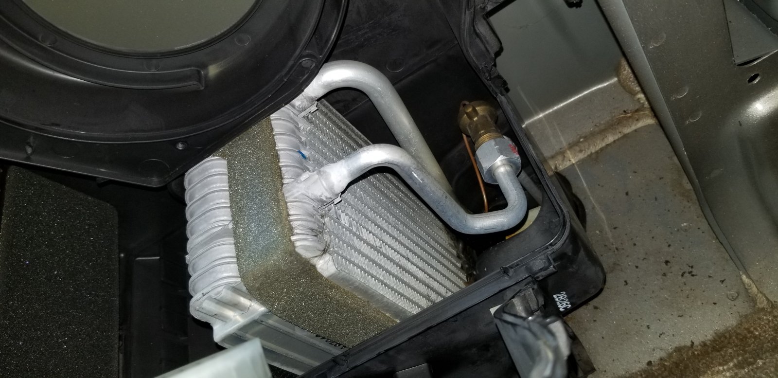

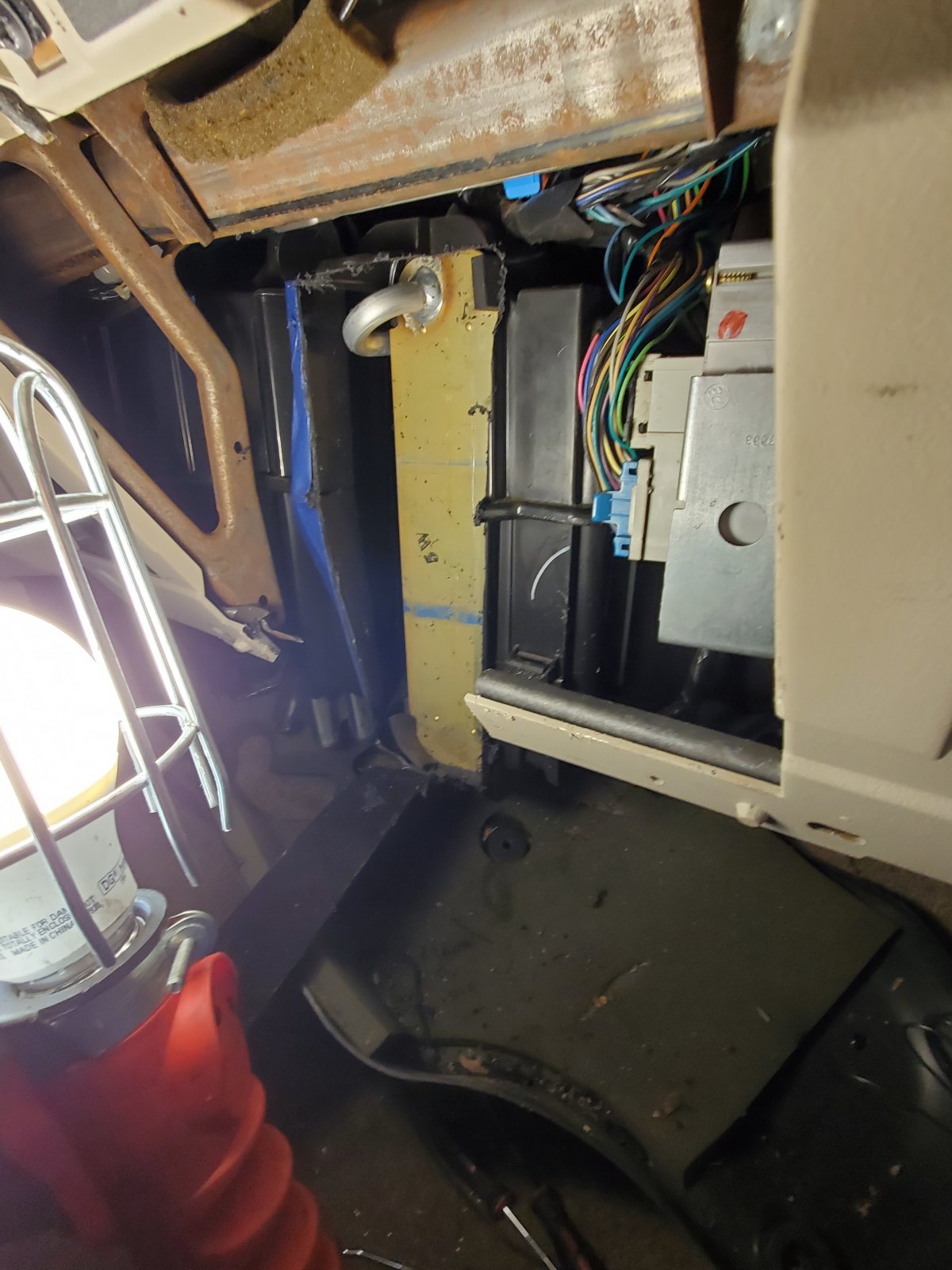

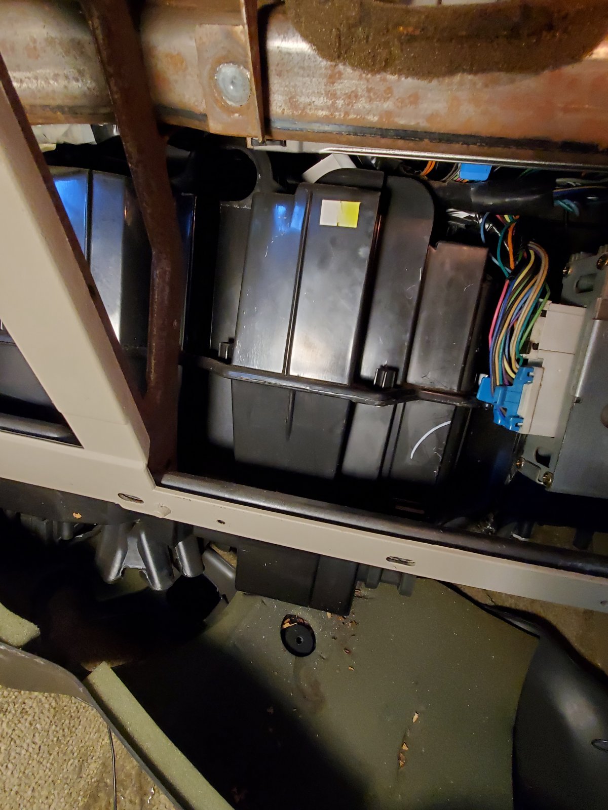

Thanks. I'm in North Carolina north of Charlotte , I have the rear air box apart and there's no corrosion.

It will not hold pressure. Sprayed all joints and connections, and no leak. My only suspicion is that the evap is leaking. I apply pressure and as soon as I remove the air the pressure drops to zero

Don, thats a huge leak! You maybe could hear it unless as deaf as me. Try spray bottle again, spray seams and tube connections- hell just spray everything, it will blow bubbles or foam trail. Those shop towels around the rear will soak it up. A leak that big has pushed some oil around to the leak too. Sounds like you forgot a gasket hopefully.

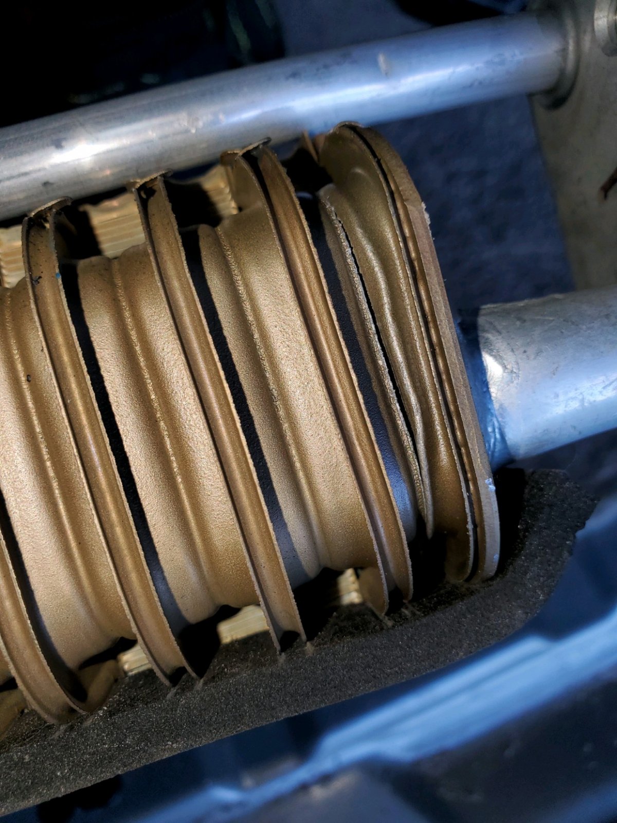

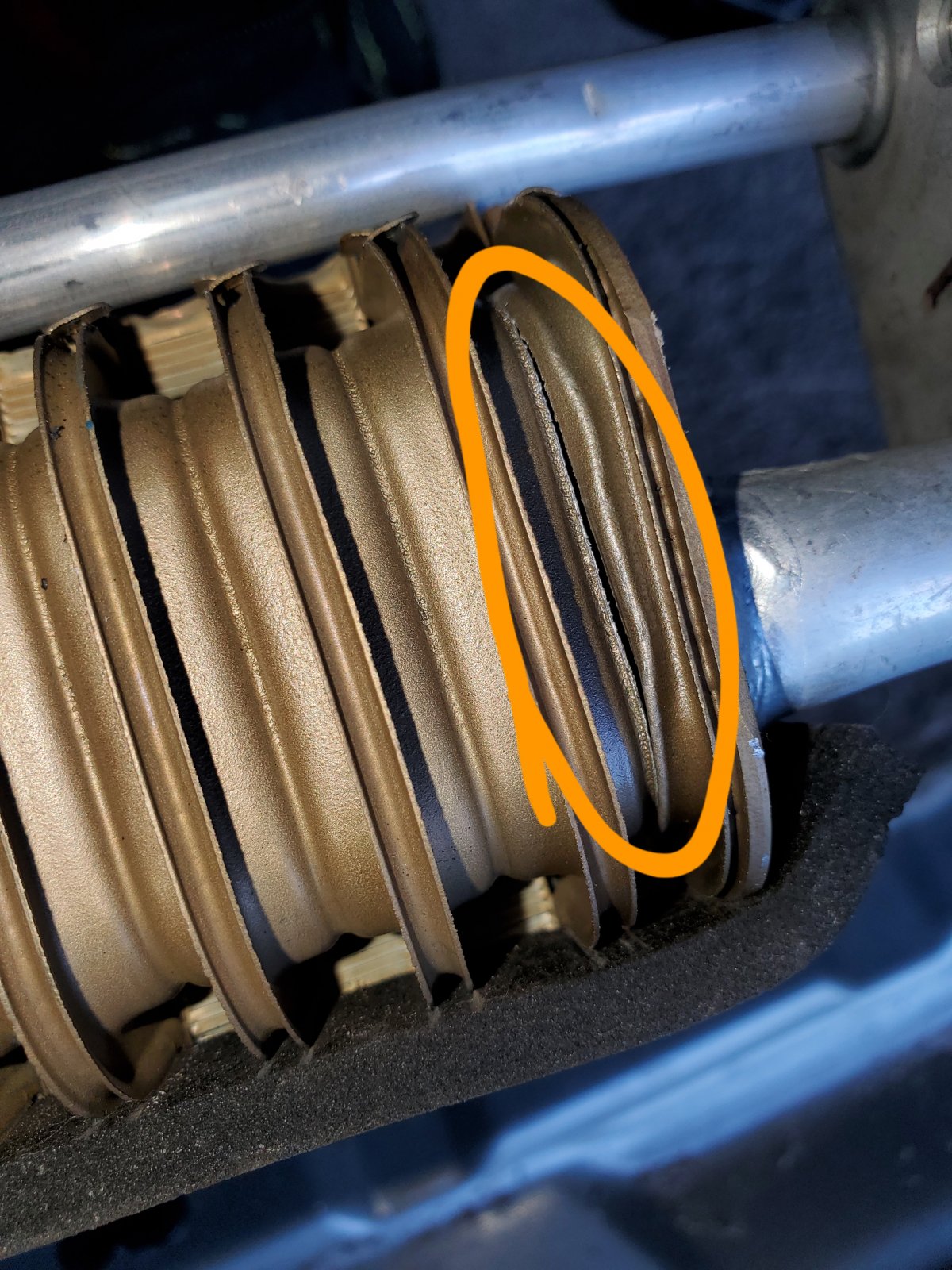

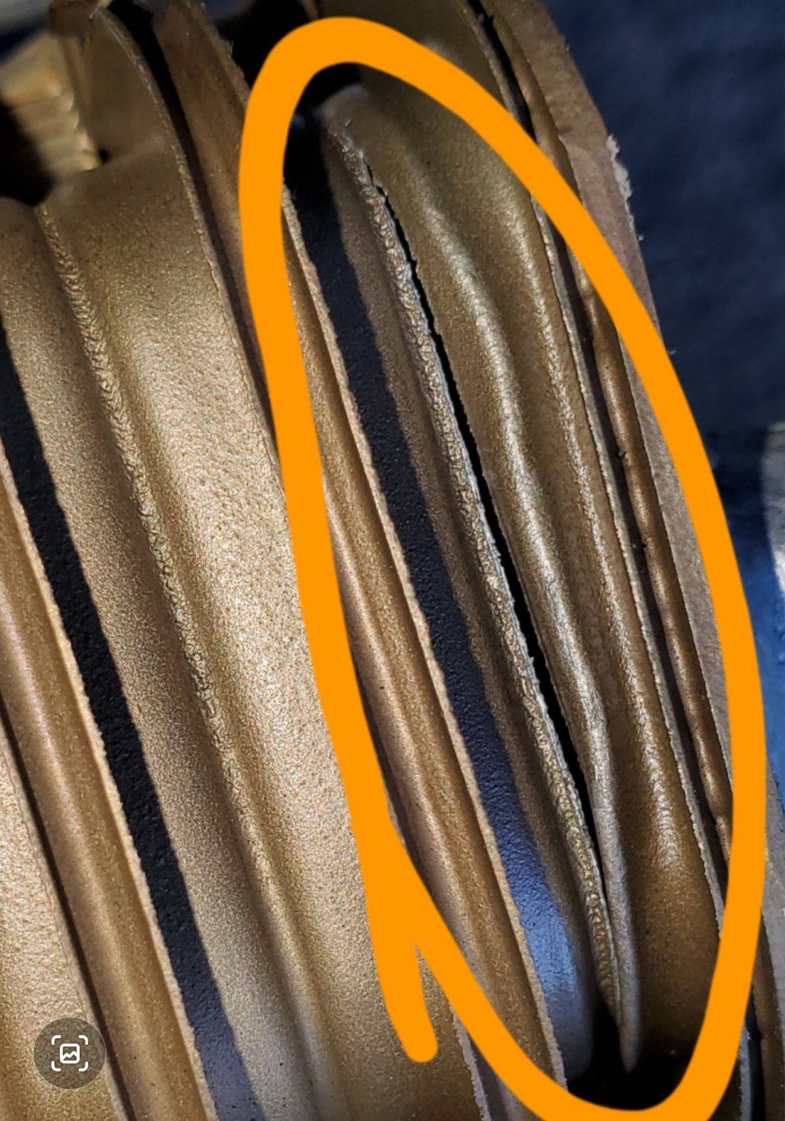

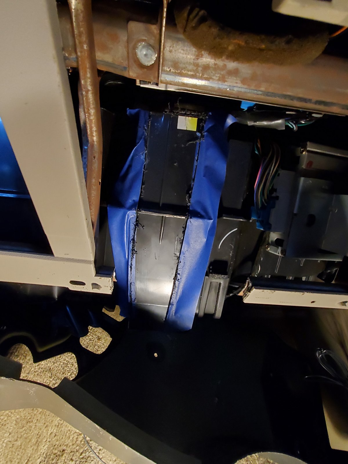

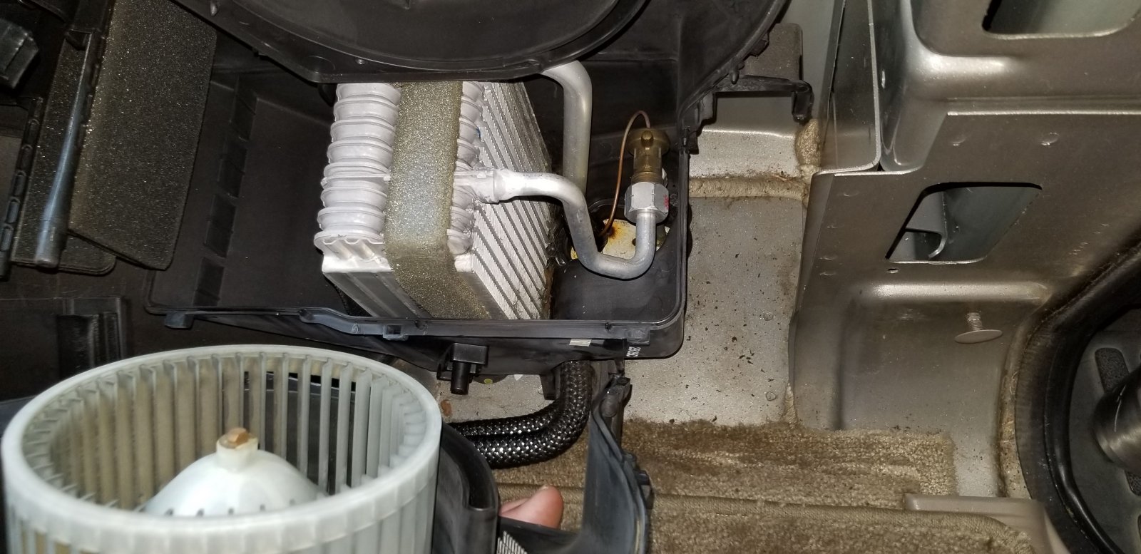

After process of elimination, I took on the task of removing the evap. I could hear air but thought it was just the air circulating . After removing the evap i found the leak. I ordered a new core and hopefully that's the only leak remaining.
I will post a follow up.

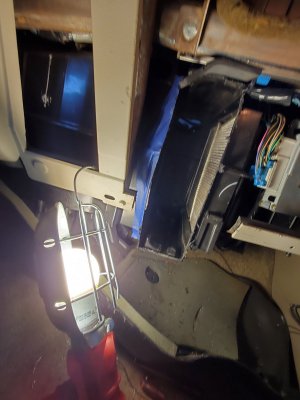

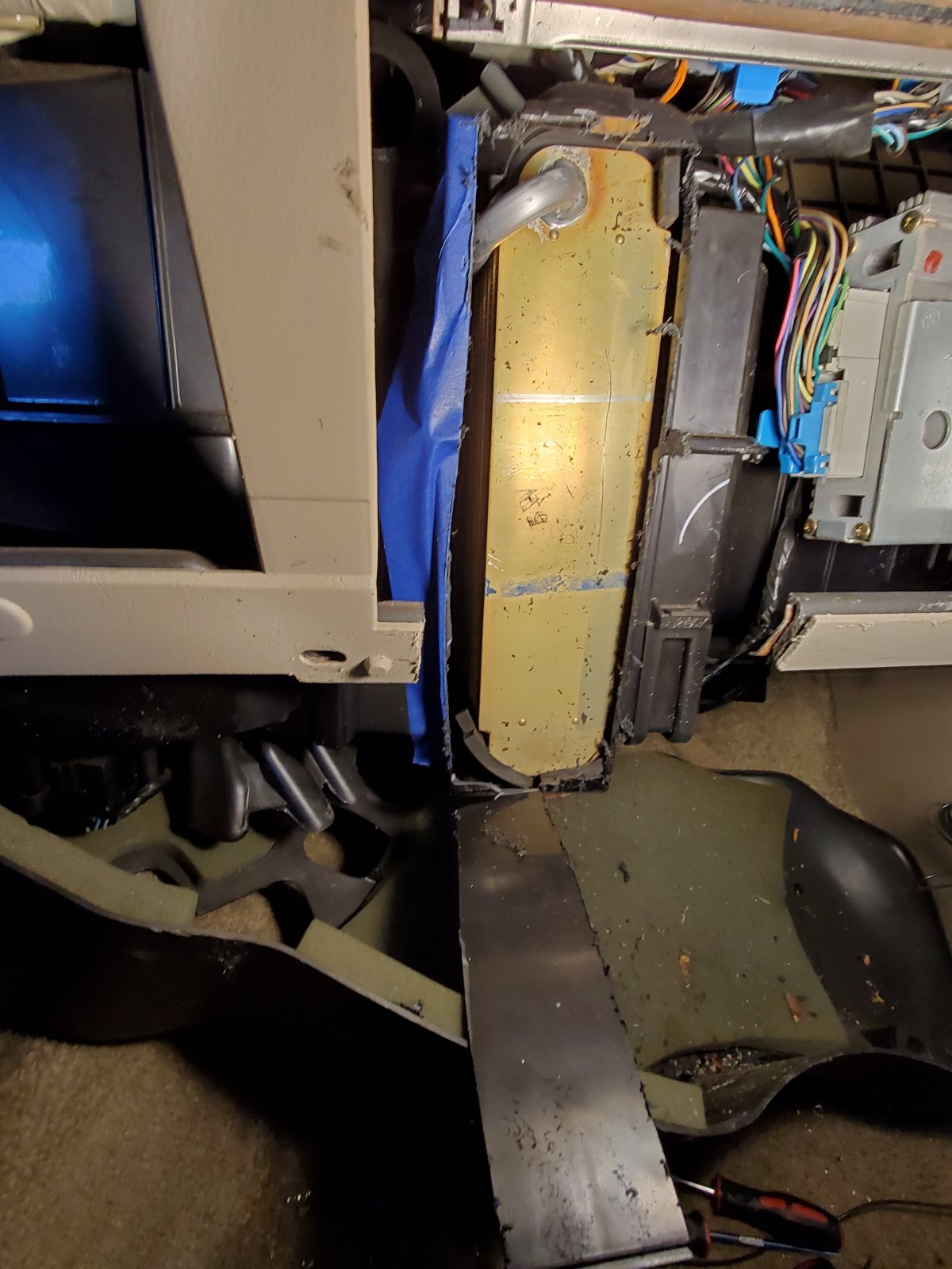

I watched a very good video on YouTube. I will look for the link, but I followed his instructions and it worked to a tee. Total time to remove was about 1 1/2 hrs or less. You need to have the tools tho. Nothing special just a sawzall or oscillating cutter

Nice. I did the same job last weekend using the same video. Have any issues doing yours? I tried putting the factory bracket back on the evaporator, but it kept fighting me--so I left it off. I hated to cut anything, but it beat dropping the entire dash.
I didn't have a factory bracket. Just rubber underneath the core and around the edges.
My new core came with new rubber

Not really a bracket, it was also made out of rubber and plastic.
I would have never found my leak if I hadn't put air pressure to it. I could hear air pushing out of the core when I put my ear down next to the dash.
