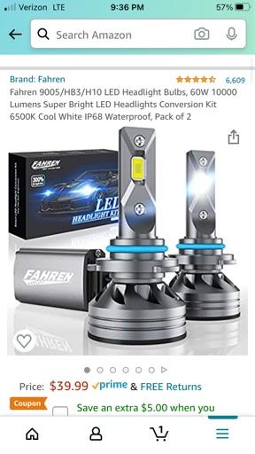

So now maybe I'll try Amazon. Or the junk yard for some stock ones and clean them up

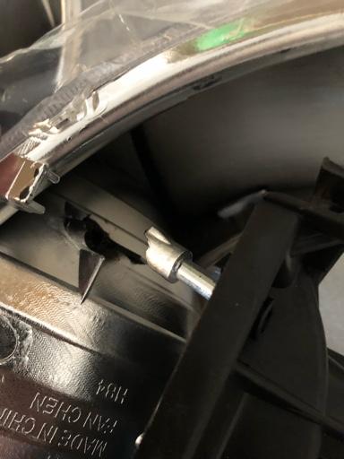

Have any of you guys with a Denali had any luck with aftermarket headlights? I ordered a set off eBay and the first set was wrong and the second set was broken.
I currently have black projectors with morimoto. But I like the clear style with just led bulbs.
I see the main problem in the lower left photo, it says "Made in China" I have an `06 Denali and I bought some Spyder headlights I purchased on Ebay. They are made in Taiwan.
You may be able to plastic weld that broken piece. I had a similar problem on my `02 Sierra.
Just kidding about the made in China part, seems so much is now. There is a lot of junk out there.

I have these led bulbs I plugged into the factory plug
