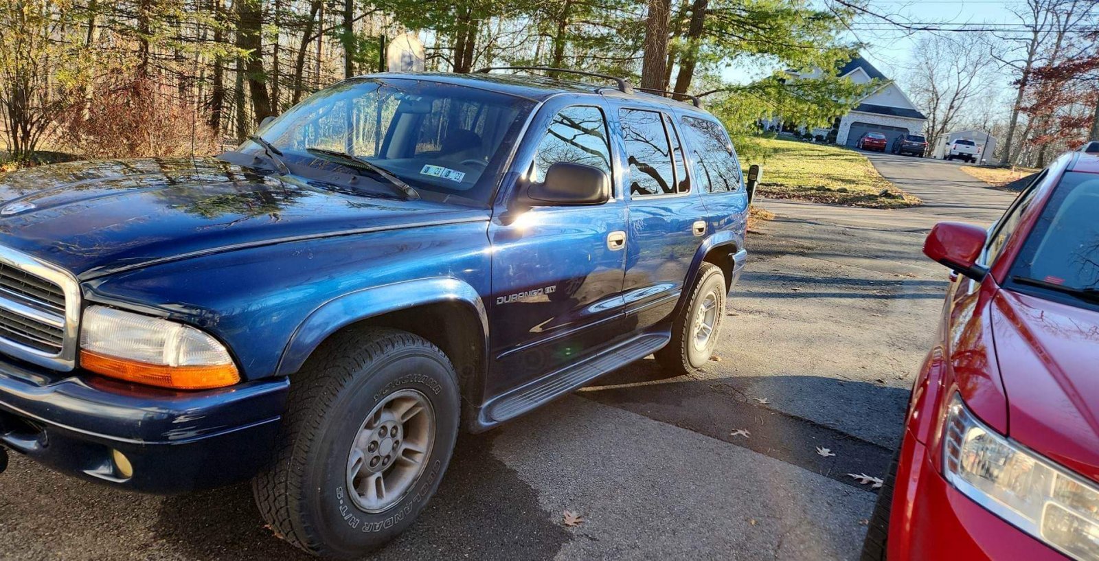

soo i dont have a gm product again but im still around. i didn't buy this one it was gifted to me through a family member passing. body isnt in bad shape and interior could be worse but thats mostly where the positives stop. it does run and drive and i do feel its road worthy besides its bleeding cold. its previous owner was a typical dont fix it until its broke and even then as cheap as possible. family does seem pleased with me giving it some love and as i got it for basically just transfer fees i think its worth dumping some money into.

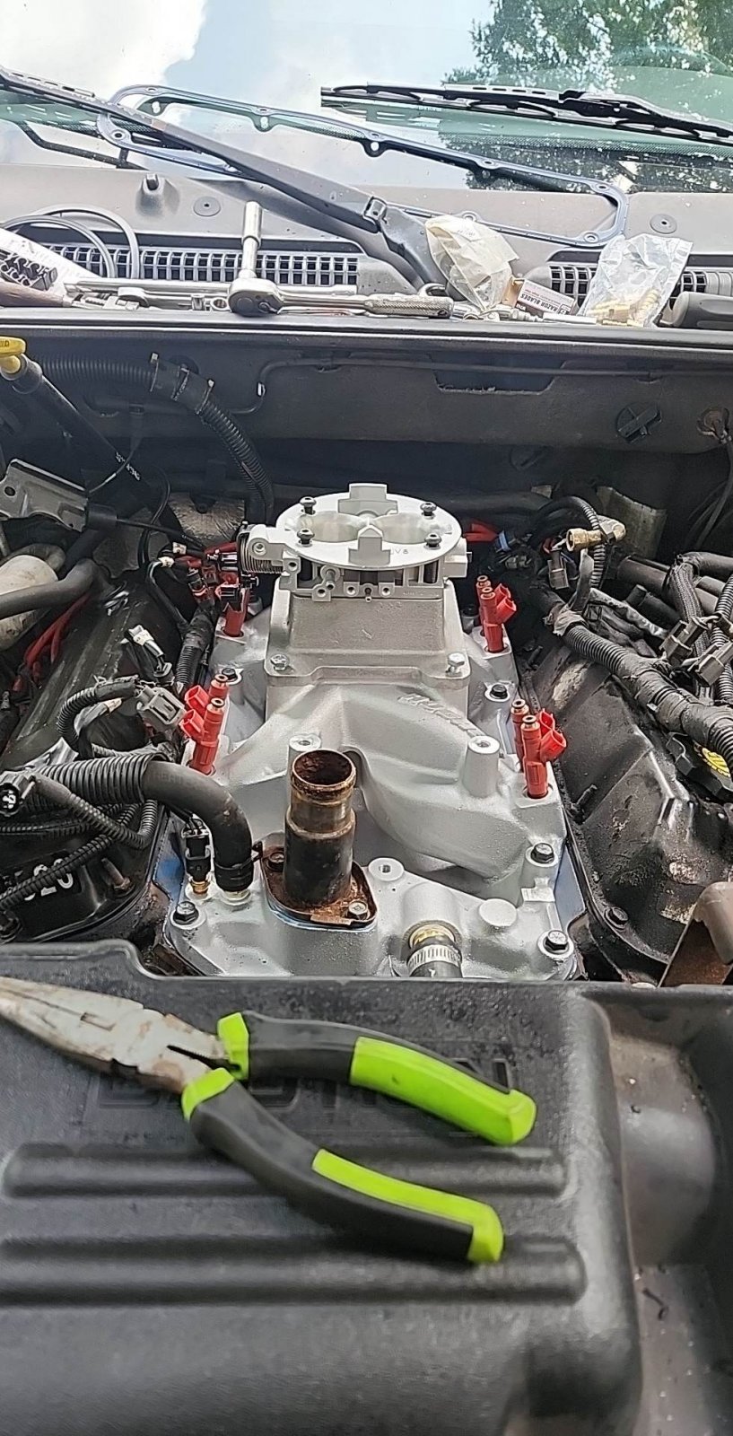

supposedly i will lose a little low end with this intake but it will permanently solve the issues with the stock kegger intake.

so truck runs amazing. i didnt notice any loss on the low end and it seems extremely more responsive. the previous condition of the truck still has me chasing annoying issues but ive got most of them ironed out. did the front brakes a bit ago and now the driver side caliper is hanging. replaced the front o2 sensor for a fault now the back sensor is faulted.
also yes my brakes always get greased with the good stuff. ofcourse my luck continues to be crap. the day i was about done just putting the accessories back on i heard a breaker trip behind me...... yup well pump died. oh it died because the well tank was shot? oh should i just hack my damn arm off now or later?

so took her out for a longer drive now that i wasn't concerned with setting my pads on fire. DEFINITELY runs way better. the mfg claims alot of people see better mpg ontop of everything else. still no noticed loss on the low end it even feels possibly stronger better around 1500. climbs the hills near my house easily with no need to downshift anymore. ill find out about mpg on Tuesday and Wednesday.
