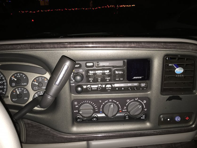

02yukxl, that bezel isn't a Denali is it? At least it doesn't look like my 02 Denali one. Mine has wood grain around the perimeter and I can't find one on EBay but the regular Yukons like the one in your picture are there. I'm just wondering if your truck is a Denali. Those bezels are also easier to mod than the Denalis if you want to use the original also; mine curves inwards around the radio/heater controls instead of being flat like yours.
