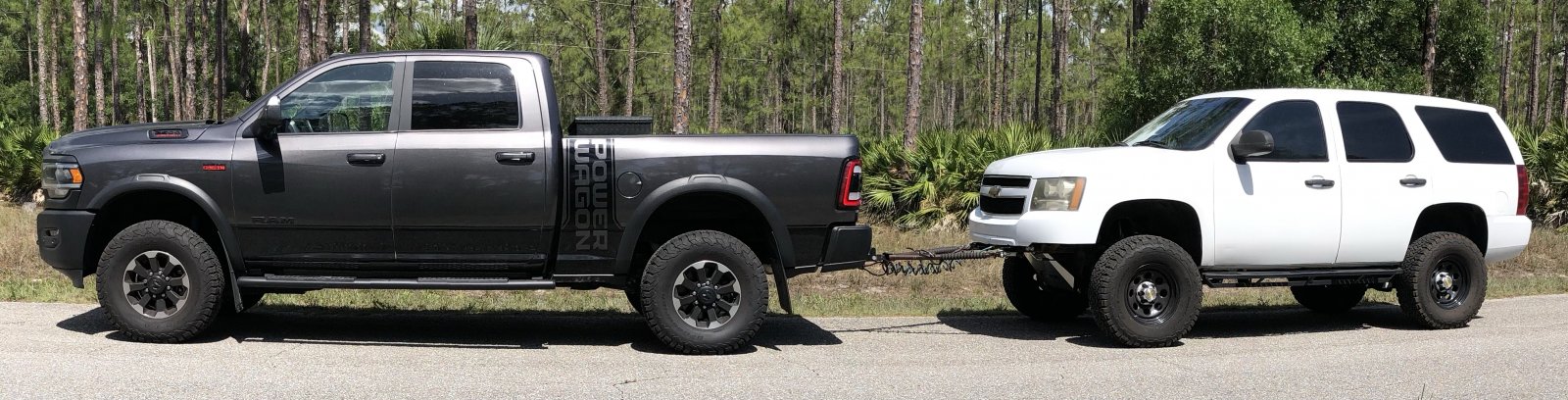

Latest attempt after another rest period it worked. :hmm:
So now it’s an intermittent problem and I have trust issues.
Here’s a pic from the test run. Can’t have a thread without pics.
