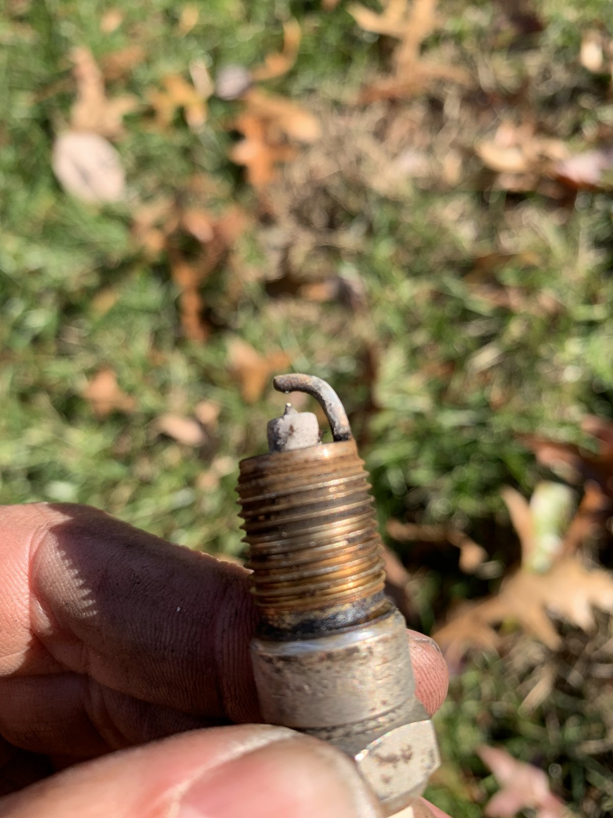

I did the test of removing MAF when the crazy idle wa happening… and the engine smoothed out. Plugged it back in and the crazy idle came back.
I swapped out the MAF that was present in my vehicle with the sensor that came with the CAI tube… and the crazy idle and “low power” limp mode stuff went away. I think the higher flow fried the MAF sensor? Or as I mention below, the battery can’t do it’s delivery enough power.
I also put in new spark plugs, went with the ruthenium plugs. The others were probably stock… 77k miles stock… or maybe changed at like 30k or something. Either way; they were beat…. And the engine really responded with more sensitivity and intensity upon pressing the gas pedal…..
My battery is also way to small for this elephant, so I’m going to get the correct one today…

Glad your initial issue seems to be resolved. Also, that plug looks fine to me.

Agreed. That plug looks used, but not abused. I replaced the plugs on our '10 Tahoe when we got it at ~60K miles, just because. While they didn't look as used as the one you show, the new plugs made zero difference in how the truck ran.
