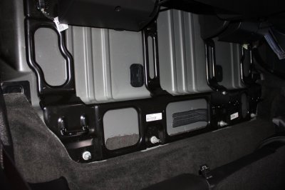

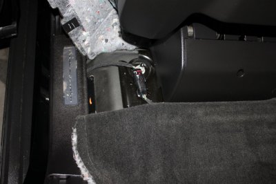

I agree logistically this would be difficult we would have to ship each other the seats. I could see freight costing about $100-$200.
I pulled up the carpet surrounding the bucket seats and it appears each bucket seat is part of a frame that is bolted to the tub in each of the 4 corners. Each seat also has an un-plugable connection for electrical components.
See Pics...

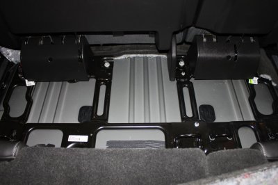

Here's my pix. I tried to get the same angles you did and then some.
Wow that actually looks like it would be a direct swap out, 8 floor bolts and 2 connections, one on each side of the seat.
What trim level do you have? My leather is perforated, for some reason yours look different, may be the angle.
Its an SLT. I haven't seen a pic of your actual seats so i'm not sure. if by perforated you mean little holes in the seat for the heat to come out of yes. BTW, the bench is only heated, not cooled as I originally posted.

I agree the carpet would also just as easily swap. Greggovader and I have been taking some photos and it looks like a pretty easy swap, 8 total bolts and two wiring harnesses if you have heated seats. I just wish we were closer, would be nice to do the swap together just to be sure everything is exactly the same.
