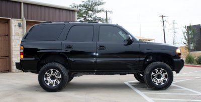

3" lift spindles, keys cranked just a little up front
2.5" spacers, z71 springs and extended sway bar links in the back with 5100's all around.
I got about 3.5-4 inches all the way around and I love it but now I want to go higher.

I can't seem to find the info for the spindles, but I got them off eBay. The links I ordered through amazon because the shipping was faster than the actual website. "Zone Offroad TJ Rear Sway Bar Link for 4-5" Lift" is the description.

I found my spindles on either eBay or amazon for around 200 shipped. Everything lined up perfect and I didn't have any issues installing them. I'm running 295/70-75/17, I can't remember 70 or 75.
I've never measured roof height but I fit in a garage with about an inch left.

Those are only 17s? They definitely look bigger than that. I thought you had 20s.

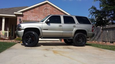

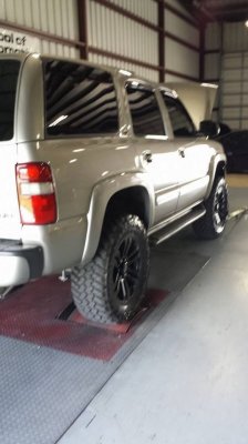

Wife's 2002 Tahoe LT Barn door
CST lift spindles and pro comp level kit ( not cranked at all! ). Six inch rear springs and drop sway bay links upgraded pan hard bar. G2 4.56's gears and a eaton ratchet locker. Running 35X12.50R20's. I also replaced the UCA's with Moog and the hubs with Timkin and new idler , pit men arms! Runs and handles great no regrets. Got the spindles from another member on here for $150 shipped! Now the tires dam near killed me Nitto Trail grappler M/T's
