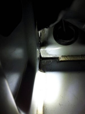

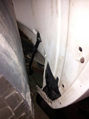

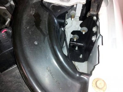

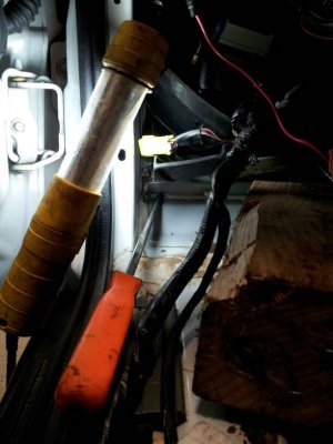

Worked on her for two days to find the infamous leak that was getting my driver side carpet wet under my floor mats. Much much trial and error and ripping the seats out and headiner and fender. Found it! Where the water comes out in the engine bay from the sunroof tube and then comes down fire wall to the ground. Well before it hits the ground it rides on the caulk line. In that caulk line where the firewall, fender and floorpan meet. It was coming in through 2 hair line cracks in the seam seal. WOW! Just think how long it puddled and puddled for me to notice the floor was wet.
All good now. 24 hour for the seam seal to cure and then I will primer and paint inner floor pan with epoxy....uploadfromtaptalk1395949004963.jpg
