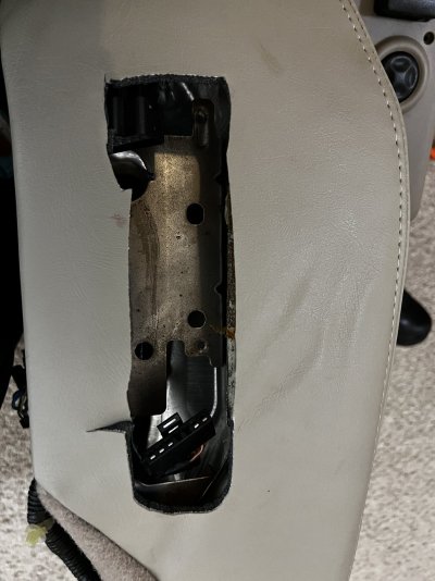

There are 5 screws that hold that plastic trim panel in place. They only stick out less than 1/2 an inch beyond the plastic of the trim panel. To get them installed, They have to be lined up with the holes in the seat fram, and the leather and the padding have to be compressed to get the plastic/screw close enough to the frame to screw in. I have spent 3-5 days failing at this task. Does anyone have advice?
I can't get screws to center things in place. I tried centering things with cut coat-hanger, but they won't stay in place, even with silicon sealer. And they pulled out of the silicon sealer before I could get things to line up (the coat-hanger wire is too thin to properly hold things lined up).
Keep in mind that when you sufficiently compress the leather and the cushioning that you can no longer see the back of the plastic, the bottom of the screw, or the frame holes...
I **REALLY** don't want to pull the seat out. And, at this point, I'm not even sure that would really help.
Can someone please offer suggestions -- either on how they've done it themselves, or how they someone else did it?
[EDIT: This is on a 2004 Escalade Platinum, and the driver's seat if not obvious. Thanks again.]
Thanks!

Ditto. I replaced the seat springs, seat foam and seat cover with a 5 screw setup securing the panel like the OP. Thin phillips were inserted in the front and rear holes to line up the two center holes. Once those were secured the rest lined up easily without a fuss. I didn't tighten any screw completely until all had a good start.
*edit* I looked for a photo where the screws attach and noted mine are slightly indented. If your panel (OP) is the same, a light touch should guide them home once the outer holes are aligned.

I wish my mess were as trimmed as nicely as yours! That's likely a large part of my problem.

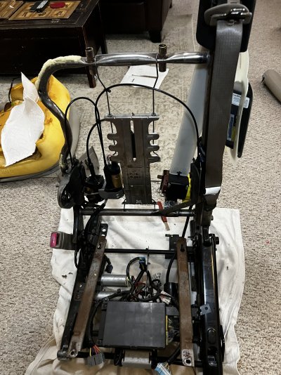

When I did the drivers side it was a PIA.
IIRC, I used two long screws on the most rearward hole & a front hole and just ended up searching for the other holes using an ice pick.
Considering doing the passenger side now… The Seat Shop is running a sale …
I actually found reattaching the sun visors to be an even larger PIA… searching for holes, defying gravity & being a contortionist….
