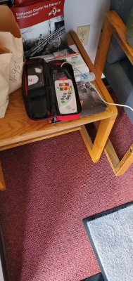

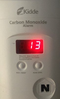

I’m positive it’s the vehicle. I have 4 CO sensors at home. I was bringing a portable CO sensor to work when it accidentally registered the CO in my car. I didn’t suspect my car until the sensor showed it. I thought it was my work place honestly, which had sensors already, but I was going to add my own new one. My work was actually negative with my CO sensors too as well as there own. My home is newer. We don’t use our garage for our vehicles at all. I even stuck new CO sensors in our garage, kitchen, every part of the house, etc. just to be safe. We already had existing working ones that communicate with a monitoring service. I don’t use chemicals. If I clean, it’s pretty organic stuff... soap and water, essential oils, etc.
I wasn’t sure of the source and started looking for it after a doctor suspected it. I received treatment for my elevated CO levels. They were medically recorded down to 1% the day before I got the vehicle back from the shop. I got the vehicle back, spent about 35 minutes driving in it, got the exact same symptoms (CO poisoning) again and my levels were measured while symptomatic at 8% by the fire department. I received oxygen and they came down to 6%. I went to the hospital per their recommendation for still being symptomatic and transported myself and my levels were 9% there. Treated with oxygen for about two hours and levels down to 0%. Had the car brought back to the dealer by someone else and no I haven’t had any symptoms since. Interestingly enough, the person who drove it reported a headache after.
I’ve owned this vehicle about 4 months, and my symptoms started around that time and have been ongoing since (looking back at all the doctor visits it makes sense.) I have multiple medical visits, just didn’t know why the symptoms were happening. With covid lockdown and working from home, I wasn’t driving very often.
Here’s the ppm reading I got from my car CO sensor when I wasn’t expecting it. I’m not malicious and I don’t plan to rake GM through the mud. I just want this known and to hopefully save someone’s life if the situation is ever occurring to someone else. I spent months being ill from chronic low exposure and it’s the worse thing ever.
