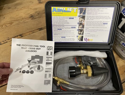

x2 on what @Doubeleive said (both posts). If you’re not close to a dealer another option would be to pick up an “Airlift Kit” like this one.
