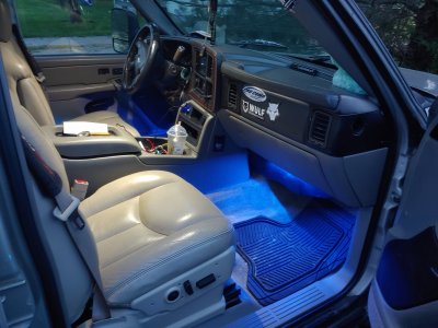

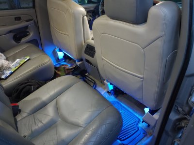

Did the 03+ Footwell light retrofit mod today.
