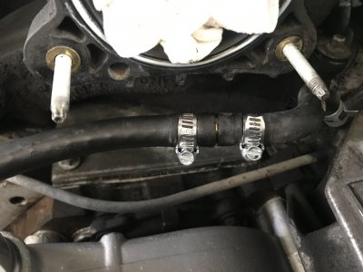

Today I put in a new throttle body.....Amazon $70. Says it has upgraded electronics and actuator for better throttle response and longevity.
Longevity? LOL the first one lasted 18 years....and maybe it was bad. Computer was throwing a TPS code and went into reduced power mode...twice, I hate those
reduced power mode codes. So we'll see if the TB was it. Hopefully not the pedal as I hate going under there.
And while I was there I did the infamous throttle body coolant bypass mod with this little piece I got from home depot, $2 LOL (1/4 inch, barbed)
Guaranteed to reduce TB temp by 15-20 degrees......reduced IATs may vary based on application but should be lower.

It doesn’t do anything. That’s an old wives tale. I did it anyway though, just to make removing the TB easier.
