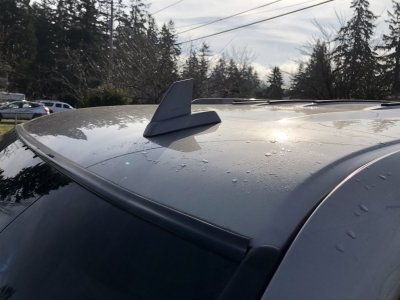

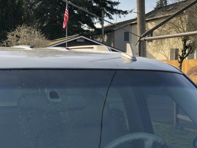

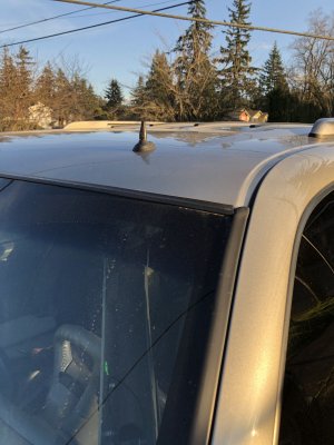

Thanks to @Sam Harris i got a PN for a possible fit of a new style shark fin to replace the old style on my 02. It fits , just doesn’t plug in ( don’t care since OnStar doesn’t work and I did have to remove a piece of plastic on the new mount part so it would fit in the hole but it looks great and sealed up good. PTM and installed today. PN is 25775201.
View attachment 272352 View attachment 272354 View attachment 272355 View attachment 272356
Looks great! Speaking of which, I was inexplicably miffed to find out that my OnStar system is no longer compatible with the service. I never renewed after the free trial when I bought my Yukon new from the dealer, but even so I was still a little irked to find out the service was no longer available to me.
