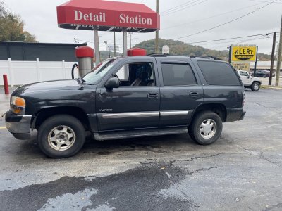

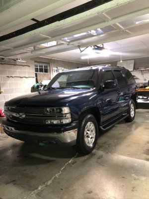

Heres a pic of the Yukon along with one of my Tahoe from a year ago. Not to get side tracked or off topic. End goal after everything is fixed is to respray this the same color blue as my Tahoe. I think it was Indigo Metallic irrc...
View attachment 262920 View attachment 262921
Awesome color ;):D
