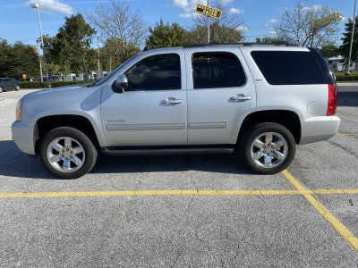

Hello all, been away for a bit due to life, but I was finally able to get the Yukon leveled. I went with Rancho Quicklifts all the way around. I also added Wulf 1/2 inch level kit in the front and ProRyde 1 inch blocks in the rear. Took a bit to figure what Rancho setting best suits the Yukon, but it all seems to be dialed in so far. Sorry, just realized I should have zoomed in a bit more on the photo. I’ll add more photos when the weather is better.

@Mighty Hd, you’re absolutely correct. After some research decided not to go with the 3” level.

@CAMASO Looks good man. They are right once you get to about 3 inches things get more complicated. I just put an additional 2.5 inch spacer in the front but I went with forged upper control arms to compensate for the angle. But now my rear axle is off center, looking into a longer track bar now.
