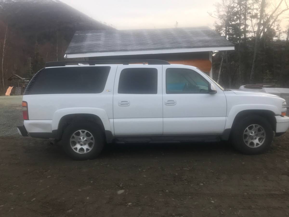

I bought it! Drove pretty good for her age/miles. The tranmission is on its way out for sure (hopefully its just a valvebody issue). The notorious 2/3 shift flare where it high revs and then eventually will catch again after letting off the throttle. The 4wd electronic motor was making a whining noise but did engage 4wd. The passenger valve cover seemed to be leaking. No burned smells on the oil or transmission fluid. Both looked to be good and clean. It does have a ding in the rear but the owner did have a huge folder with maintenance records. Looks like normal upkeep was done. There is a check engine light on. My mechanic wants me to bring it in tomorrow to have a look and let me know what else I couldn't see during my visual inspection.
Bunch of small interior stuff, typical chevy buttons rubbed clean off on the radio and the other plastic dash button lights not working around the HVAC controls etc. The passenger window wont roll down, the rear defrost clip on the driver side is no longer attached...
Has some pitting/rust up front... Nothing my HVLP gun can't take care of come summer time.
Here is a picture.

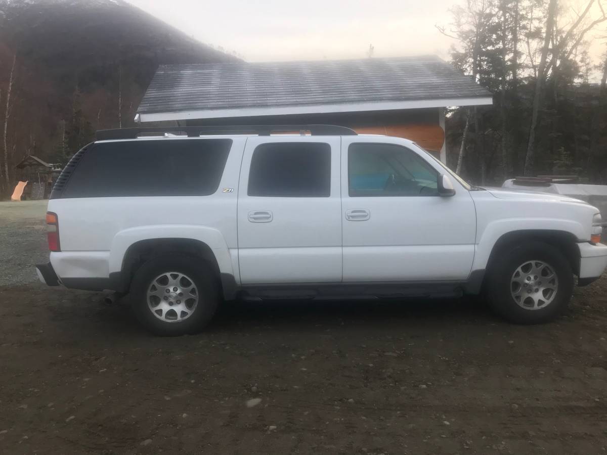

Here is a picture.
Didn't know it was a Z71. Awesome!
