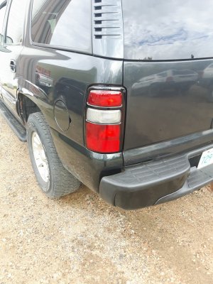

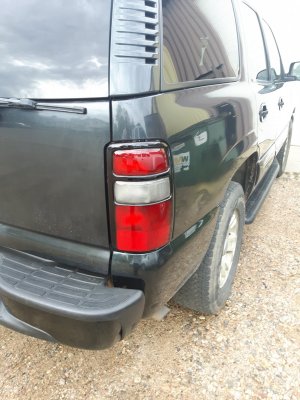

You just use sand paper & polish? I've got LEDs. Always thought they could be better though.
I did the puddle lens ..... Sanded with one of those square sponge sanding pads, then polished it with a polishing wheel pad on a drill ( mounted on a vise)..... using rubbing compound.
( 20 minutes total per lens )
Came out clear. I got LED's and the lamps are nice and bright.

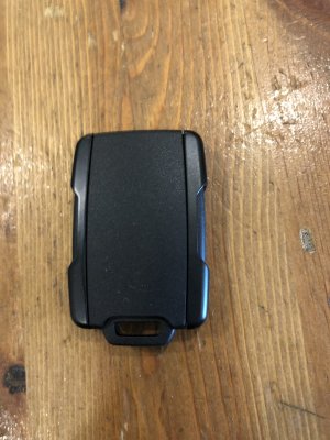

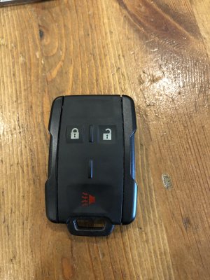

The chrome plastic edges on the ‘15 style fobs I bought were killin’ me so I bought new all black cases off EBay and they came with metal instead of plastic edge parts plus no logo on the back. I likey.
AE6E4C45-765D-402E-B620-A7332538477C.jpeg 552068FB-5EBD-4C62-B88A-DBE926EACE48.jpeg
