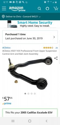

Ordered acdelco pro upper arms and got some made in china. Are these still good arms? They do have the blue boot on the ball joint atleast...so I guess they aren't the "advantage " junk
