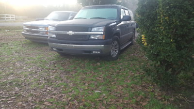

The details are still a work in progress but I figured I could make the cat eye work with the OE suv bumper for a tucked look over the squared cat eye bumper but it's time consuming to plastic weld the bumper tops together
At the point when these pics where taken they was no plastic welding done. I was actually still mocking up

Every bumper I see sticks out like its bubba shrimp's fat lip. What did you do to get it flush like that?
All that is. Is the stock bumper like 99-02 truck or stock 00-06 SUV bumper and brackets and all I did was cut, graph and plastic weld the cat eye bumper topper to the stock suburban one. I don't have pics of cutting that up. I'm taking more pics it's not finished yet with rain and cooler weather and when it's done it'll be smoothed and painted
First pic is before I graphed cat eye topper
Funny thing bout how all this got started was I didn't have a cat eye bumper so I was gonna drive without one temporary and when we got done me and looked at the factory bumper and had same idea as to curious what it'd look like till I found a bumper. Well I noticed it matched up but was tucked so here we are now lol
33,203
51,461
View attachment 213473 View attachment 213474 View attachment 213477 View attachment 213478 View attachment 213479

I have to make sure I'm understanding this right... That's the 99-02 Silverado / 99-06 Tahoe bumper on there, and you didn't cut the brackets or modify that in any way to make it flush with the cat eyes?? That the cat eyes front end headlights/body panels/grill is just a few inches longer and lines up to sit flush like that without any modification?? That the ONLY thing you have modified is the bumper cap????
Is there any chance we can get a few more angles of that, pulled out to see more? (I'll be patient if I NEED to).
Are you going to smooth out just the cap, or the cap to bumper and lower also?
***The next questions are going to be, could you get a picture showing how your wheel sits in the wheel well. Are you dropped? What size wheel and tire is that?

Correct I unbolted bumper put cat eye clip on then bolted stock bumper right back. Never even took the end brackets loose from the frame. The cat eye front is longer and takes up the extra room.
And as soon as I finish the plastic welding I'll pull the top off body work it, paint it then pop it back on like it was a "factory piece"
