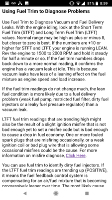

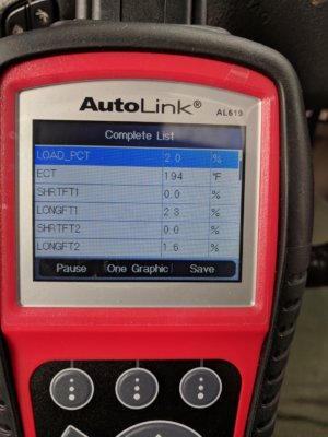

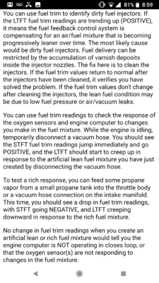

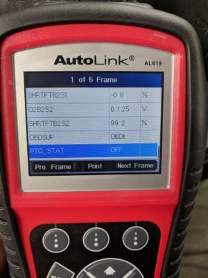

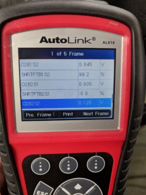

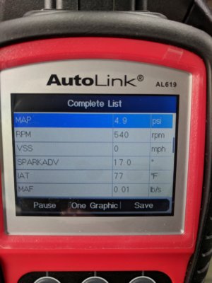

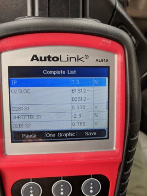

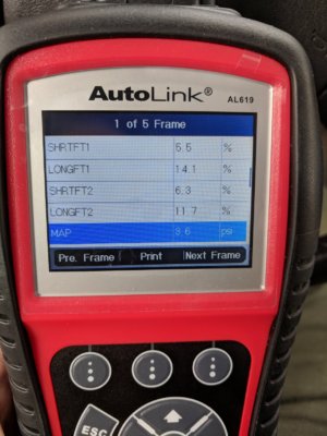

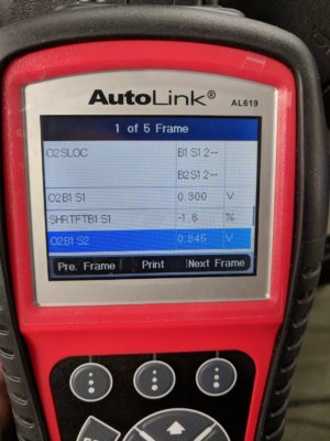

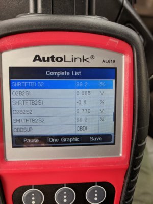

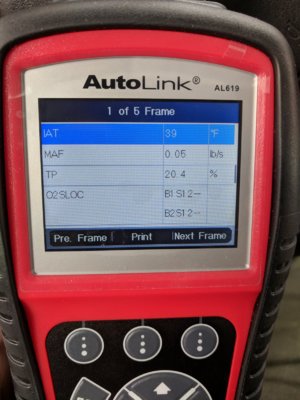

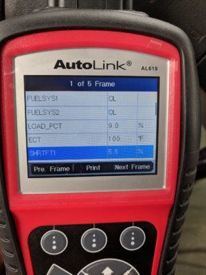

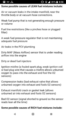

when the car is cold the fuel trims are normal but as the car warms up the fuel trims get higher and higher. when cold. both trims are less than 5%, but the time the temp is around 195 the trims are anywhere between 18% and 25%. the screen shots below are what I've been going by when deciding if it's a vacuum or fuel problem

all i know is a pegged ltft of +16 is a vac leak 100% of the time.
can you scan bank one and bank two ltft's with the scanner you have? that would narrow it down to what side is having a issue.

this one is up there but not real bad.
img_20180308_141230-jpg.194366
this one at idle looks ok to me really.
mine stock was leaning out to +8 or so wot in the higher rpm. stock tune kinda sucks. they run em lean for some reason.
just holding the rpm's in park is not the same as being under load driven, just noticed no mph showing.
over all thats not horrible. not great either tho.
