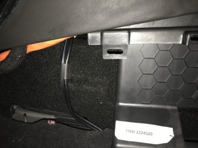

A small update. Yes the JL stealth box does fit. No it doesn’t take just an hour like they say. The instructions are for a Tahoe. In the Escalade you have to remove dash panels to remove the center console. Right now I have it running off the stock Bose amp I didn’t have the time to run my 500/1 and I wanted bass still.

Where are you pulling your signal for the LOC?

With the JL amp you don’t need a LOC. I used The JL Audio XD CLRAIC2 SW. it’s basically rca to speaker wire and attached it to the sub output from the Bose amp. The JL 500/1 is way too big for that sub so I have the gains all the way down. With the gains turned down the signal sensing doesn’t work as well as it should so I went to the 12v outlet that’s on back of the center console because it’s switch for the remote turn on. I was surprised how hard that sub hits. I may end up installing a LOC to Fine tune the bass a little more.
