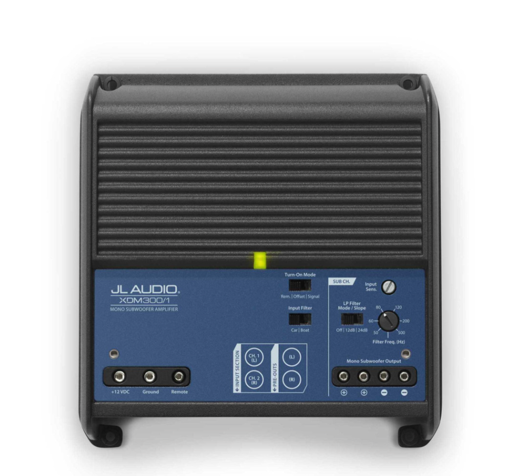

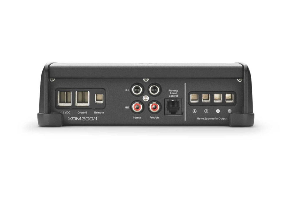

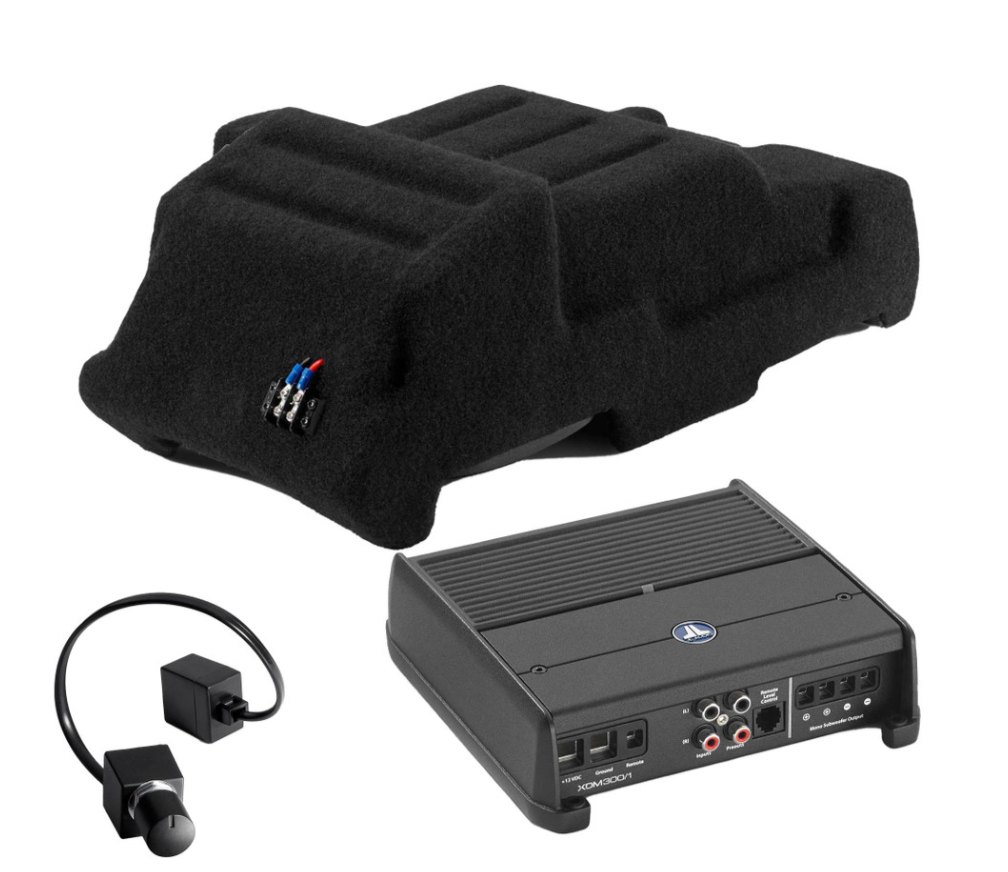

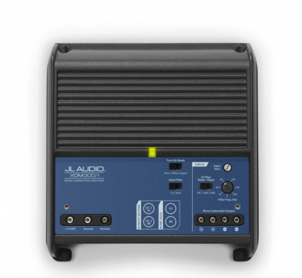

Hey what's up people! I'm adding a jl audio stealthbox to the factory system (2019 midnight edition). It's only 300 watts. Is this gonna require a "big 3" upgrade or better yet, what would be some recommendations y'all would suggest for this setup in regards to not burning up my battery or alternator? It's been forever since I've messed with anything sound related and I'm passed the days of my lights dimming every time the bass hits . Anyway here's the info:
(Came up on a nice little bundle)
The Hard Data: Contains one 10TW1-2 in a sealed enclosure. 300 watt power handling. Wired for 2 ohm mono. Stealthbox® installs inside forward-most portion of front center console, without affecting storage space or cup holders. Replaces the OEM “subwoofer” system, if vehicle is so equipped.
JL Audio XDM300/1 XDM Series Monoblock Class-D Car/Marine Subwoofer Amplifier, 300 W
Specificiations:
Rated Continuous (RMS) Power @ 14.4 V
@ 4 Ω: 200 W RMS x 1
@ 3 Ω: 250 W RMS x 1
@ 2 Ω: 300 W RMS x 1
@ 1.5 Ω: N/A
Rated Continuous (RMS) Power @ 12.5 V
@ 4 Ω: 160 W RMS x 1
@ 3 Ω: 210 W RMS x 1
@ 2 Ω: 270 W RMS x 1
@ 1.5 Ω: N/A

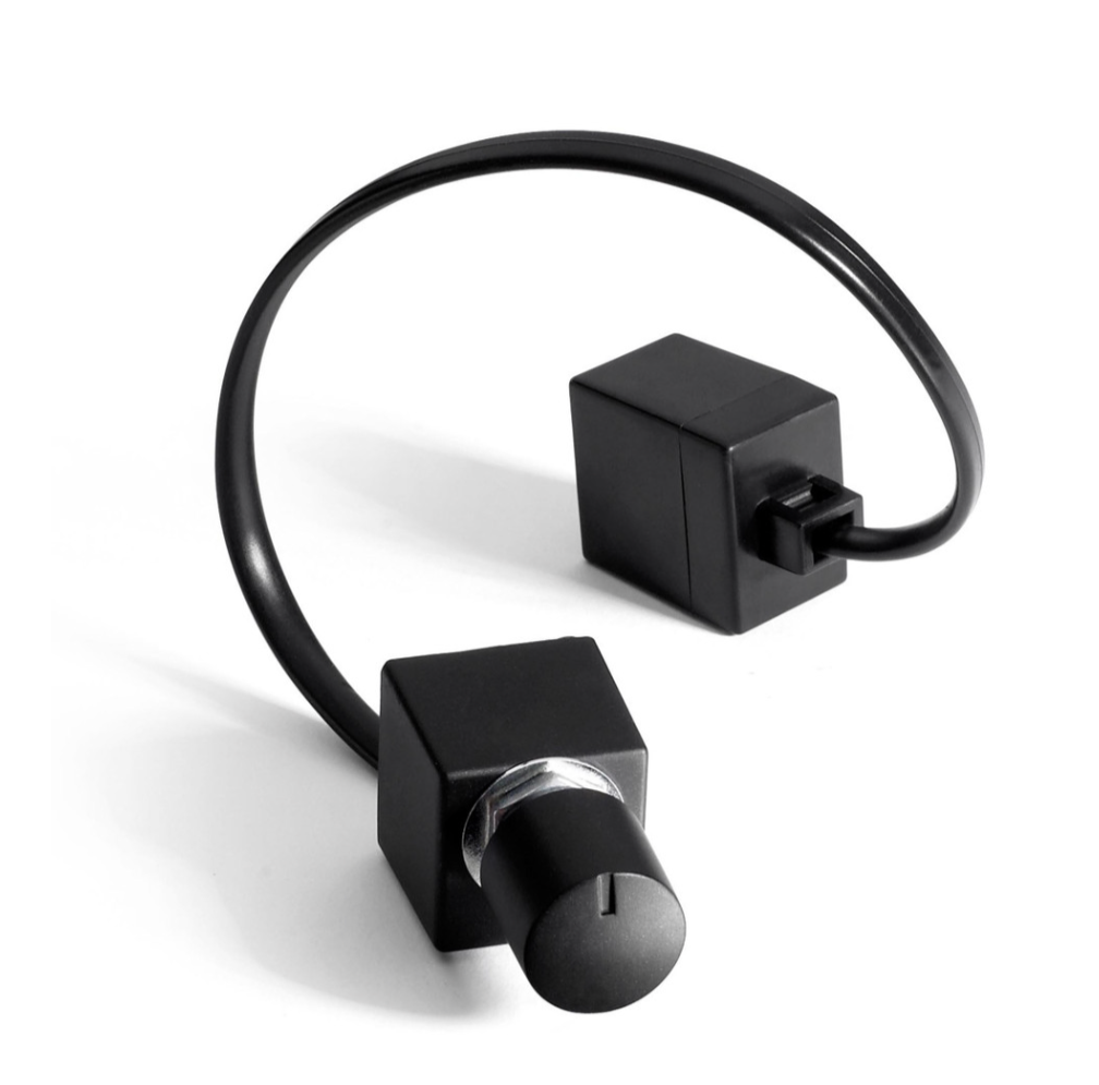

JL Audio HD-RLC:Amplifier Remote Level Control and Cable
Thanks in advance!

300 additional watts is easily handled by your existing electrical system. Just wire your power wire to the amp directly to your battery with an appropriate power block and gauge of wire (#10 gauge should be plenty). It certainly won't hurt if you do the big 3 upgrade, but it is not necessary in your case.
I'm running 800 watts out of 2 amps, and I did not make any modifications to my truck's electrical system.

Do you know what alternator you have? 150, 170, or 200a? That amp produces 300w, and as a Class D should be (at worst) 80% efficient, so it'd actually use 360w. Since we have a PWM based alternator, the voltage can drop as low as 12v while running, so we will use that for our calculations. 360w\12v=30a, so at full tilt, it should use 30amps. At idle, if it you have a 150a alternator, that might be pushing it (if it were continuous, but it's not). I can't seem to find an output graph for these alternators, but it's max output won't be at idle. The Big 3 is relatively easy, and ensures you'll get the most out of your charging\electrical system...so I'd do it on a stock vehicle.
