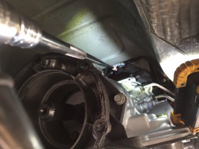

Holy crap this is kicking my ass. I got the trans mounted by 10:30 this morning but ran into trouble bolting up the torque converter; FTI's instructions say if the gap between the flexplate and the converter pads is over 3/16" I need to install .060" washers as spacers. I tried for 2-3 hours but couldn't get them in. The flexplate is in the way; you're working through the starter hole and the hole in the flexplate is way back from the edge so I was trying to use grease to stick the washer to my finger and then hold it against the back side of the flexplate and slide it in and stick a bolt through because I can't hold it and put it back there. Every time I (thought I ) had one in and the bolt started, I had to slide out and go turn the crank over until I thought the next bole was close to the hole down there, then go down and use a screwdriver to line the next bolt hole up where I could get to it and the washer, and every time I thought I had one in, it would fall out when turning the crank. I did each bolt at least 4-5 times. I couldn't even see if they were in by using an inspection mirror. It's real hard just to get a bolt in, much less reach around behind and slide a washer between the flexplate and converter. My gap is maybe .030 over the .187 (3/16") they spec. I'm going to leave it. So then I started installing the transfer case but the trans was hanging too low so I tried leaving it jacked up and hanging with one end on the rear crossmember while I installed the front (trans) crossmember. I was using a second floor jack on the trans and needed to lower it a bit to line things up but lowered the wrong jack and the t case came down because I was watching the trans and it wasn't coming down! But then I figured I needed to install the exhaust first anyway so I started on that and it was fighting me so I just stopped for the day. I'm beat. This is hard with one person. I'll get it tomorrow though. I made a lot of progress today.
Wow. My only question, you did or did not ever get the washers in?
You are a beast, Red. Keep at it.
52,956
Couldnt use one of these to turn the flexplate?
I had one of those but sent it back, there wasn't enough room to use it. And no I did not get the washers in. I might try again tomorrow but I want to see how others have done it. I can't find anything on YouTube or online yet, everybody just says to add the washers, nothing about how impossible it is. Maybe it's the TCI flexplate that's making it extra hard.

The washer has to go between the flexplate and converter. Then it has to magically stay (using grease) while I insert a bolt through from the front, through the flexplate , then through the washer, into the converter. All I can see is the face of the flexplate in the hole where the starter was. The washer has to go behind that and I and barely get a finger back there. The hole is about 1 1/2" from the edge of the flexplate also. And the gap between the two is less than 3/16" where I'm trying to slide the washer into, and it's on top of a pad on the flexplate so I can't just hold it flat and slide it over. I have to try to get it up on a pad and use the edge of my finger to slide it into position, at which point I lose touch of the edge of the washer completely. Then I use a screwdriver through the bolt hole to hopefully find the center of the washer but I can't see it or even feel it anymore and of course gravity is against me. I tried using an inspection mirror to double check but I can't tell if it's in the right place. It's total ********.

The access to the flexplate on these is ridiculous. There should be a removable part of the bellhousing. You have to have the flexplate in exactly the right position to be able to insert a bolt, there's barely enough room. Then to try and slide a washer behind you have to move the flexplate (which is attached to the crank of course) an inch or so then try to slide the washer behind and then put something in through the hole to hold the washer while you move the flexplate back to where you can put in the bolt. I never even got a single one in even though at one point I thought I had 2 in but then one fell out while I was working on the third so obviously it wasn't in, then since I wasn't sure which one fell out I was going to remove the other one but it also fell out so it wasn't in either. I mean, if 1 falls out you have to retrieve all 3 since you can't see which one is in and which one is not.
52,956
Are you using the oval hole first?
What oval hole? I have no oval hole or rectangular hole in the converter like some instructions say. Or in the flexplate. As you can see, there's actually 3 holes on each pad of the converter for some reason, only one of each lines up with the flexplate holes.

I decided, after doing a lot of research, that the gap between the flexplate and converter is OK. It's about .02" over the .187" that FTI spec's (It's .207"). I read in several places that anything under 1/4" (.250") is acceptable and in fact Performabuilt's instructions call for 1/4". So, with that settled, I finished up everything this morning. The hardest part was probably the transfer case, both getting it in place as well as tightening the bolts. I followed the start-up instructions which call for starting it with the wheels off the ground and going through all the gears although I did so very briefly since my transfer case isn't supposed to be operated that way. At first the wheels didn't move and I was a bit worried but after a few seconds they started going. I just ran it through the gears once and then let it down. After adding a bit more fluid, I drove about a mile like instructed and came home and re-checked everything. No leaks. No issues. I took the trans jack back which was a few miles and traffic was horrible but I did hammer it once and it definitely accelerates better with the stall. And it does a full converter lockup at 40 MPH or so which is kind of cool and might help gas mileage when I don't hammer the throttle. I'm gonna take it out again in awhile after a bit of unwinding. The Beast is back!
