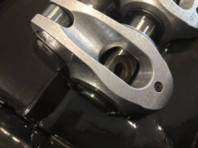

OK I said I'd wait until I did the cam but oh well. Found them for $564 shipped from Hinson Motorsports. YT wanted $797.50 shipped and even my bud Roger Vinci would only give me $599 plus shipping so I jumped on this deal. I raced a modded Subaru STi today and it was neck and neck up to 80 when we stopped. Got a big thumbs up. Those little cars are quick.

Just got UPS tracking info on the roller rockers and it looks like they'll be here in time for install when I do the cam and other stuff next week. Bad news is it's going to be 100 degrees on those days so I'll have to work in the mornings and evenings.

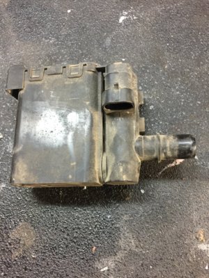

Today I replaced the vapor canister vent valve due to a DTC P0446 a few days ago. Easiest part I've ever replaced. Hopefully no more codes. There was a TSB on this also, about its filter getting clogged due to dusty roads and I certainly hit some dusty ass roads last week during my 4 wheeling.IMG_6922.JPG

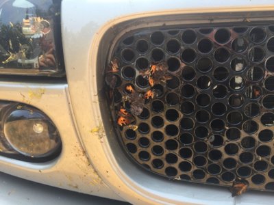

Went camping and ran into some migrating Monarch butterflies. I've never ran into something like this, it was crazy. Bug splatters everywhere and when they flew into the windshield it actually made me jump a few times. Then I got home and UPS showed up.

You butterfly murderer!! :whymewhyme:
Adds some color tho, nice custom touch :rotflmao:

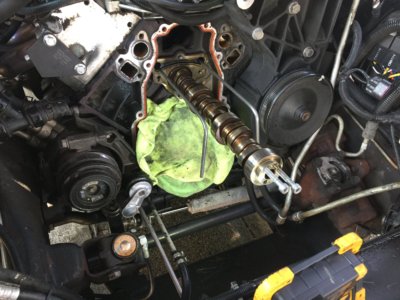

I didn't even notice! And it's CAM SWAP DAY !! Almost 5 hours into it. Here's a sneak peek. The cam is in and I was contemplating whether or not to install the new timing set and oil pump and decided I would, but to do it the "easy" way by just dropping the pan a half inch so I can get to the pickup tube bolt at the oil pump. So I pulled all the bolts on the pan and removed the crossmember but the pan wouldn't drop. Then I counted the bolt holes in my new pan gasket and saw I missed removing one. And I can see it but I can't get it out without dropping the front differential. Now I'm at another decision- drop the diff and then go ahead and drop the pan or leave the oil pump and timing set as is. I have great oil pressure and the timing chain looks great but I have these parts...damn. Stupid AWD.
