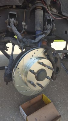

First time doing a brake and rotor job. Not too bad, worst parts were figuring out you have to compress the piston to even get it out of the bracket and then snapping my breaker bar on the last bracket bolt. Had to use a wrench in a pipe to finish the job. Just finished the instructions for breaking in the pads, and the increased stopping performance is definitely noticeable.

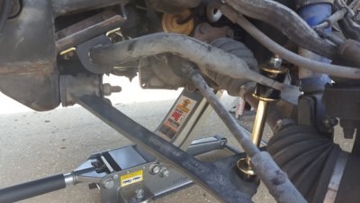

Polyurethane sway bar end links. Super easy to install. Compression looks a bit odd in the pic because I've got it up on jacks.

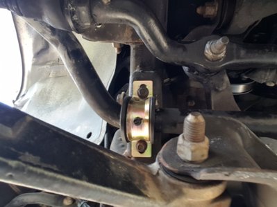

Polyurethane sway bar brackets with zerk fitting.
Mid-job on the Powerstop brakes and rotors.
