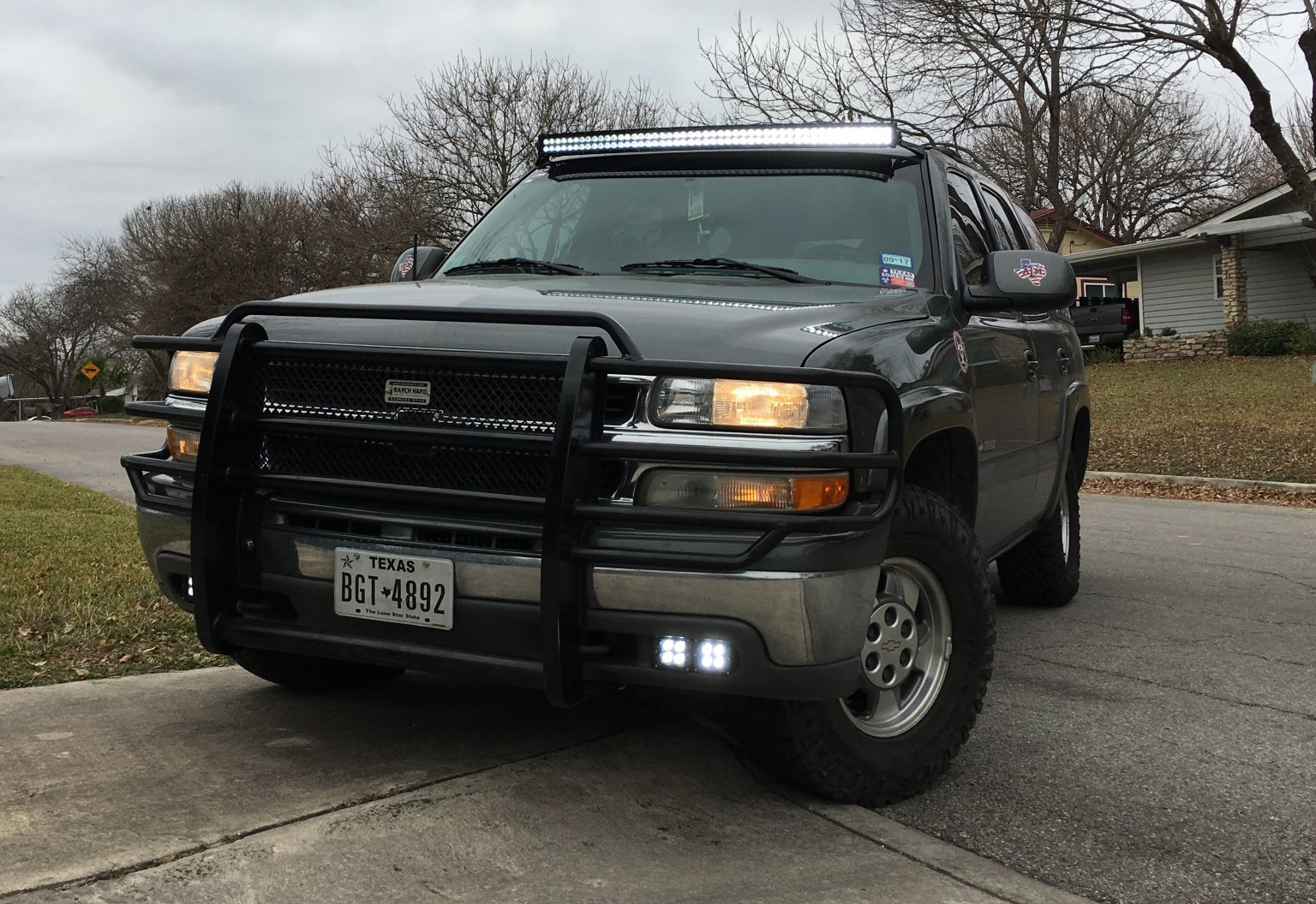

If you just want a basic upgrade over stock check out the Depo projectors. They are pretty popular and even with the stock bulbs are a nice upgrade.
I put a set of LED cubes to replace the factory fogs and with the 4 on HI (actually 6 on HI) mod I have PLENTY of light especially in rural areas where I can use the brights.

Yes, I'm looking for just a basic upgrade over stock. I'll check those out.
What LED cubes did you go with? I've heard a little about the Rigid ones. And how do you do the 4 on HI (or 6 as you mention)?
Also, had to mention I like the look of your Tahoe in you profile picture. I'm going for a similar look.

Rigid makes awesome lights, but waaaay overkill and not necessary imo. I went with these, super cheap and work great: https://www.amazon.com/gp/product/B00IY3YLCI/ref=oh_aui_detailpage_o02_s00?ie=UTF8&psc=1
Fleece Performance makes a nice part for the 4 on HI mod, priced right too: http://fleeceperformance.com/gm-all-lights-on-module.html
Thanks for the compliment, it's actually a old picture and a few things have changed, I need to get an updated picture posted. ;)
Thanks for the links! Yes, I thought that was a lot for the Rigid fog lights and was hoping for something cheaper but still good.
No problem. If you have any updated pictures I'd like to see them if you have them or send them when you have them.

thats a flood light though. Sounds like OP is more interested in a "Spot" light as distance is important to them.
Just Something to think about

I was just looking for all options. Those fog lights 4WDTRK linked looked like they do some of a "spot" light along with a flood of light. I'm ok with the fogs being somewhat of a flood of light if they provide a little bit of distance and also have projector headlights with 4 on HI mod.

Yea I was back and forth between spot and flood when I bought those. After reading lots of reviews I opted for the flood in the end. The only place you're really gonna get to use them is back roads and rural areas and I'd rather have better visibility towards the sides of the road. After using them all I can say is EVERYTHING is lit up! They work GOOD! lol :waytogo:
