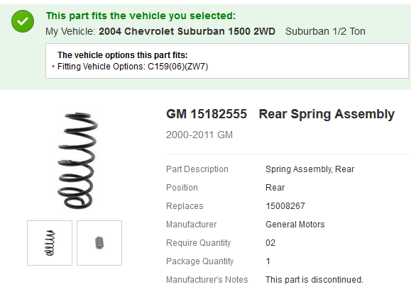

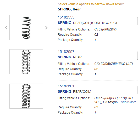

The ZW7 OE spring part number is the first one. Others shown for reference.
