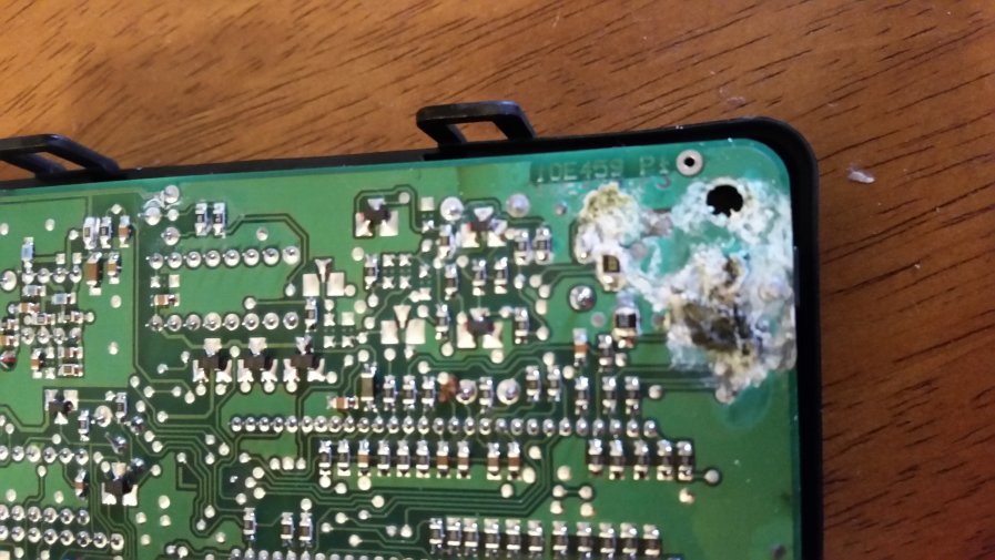

Update:
Everything looked good tell I turned it over
Thanks again SunlitComet for the info on this stuff now I have to track a new one down then have it programed would have not known where to turn without your help

picture is fuzzy to me. is that a burn out i am looking at or corrosion? did something spill in there? In any case, DAMN!. that is harsh.

True I think the person before me spilt something down there and it got a maybe because when I got it the center console was really dirty and sticky

Do you know if I found one out of a 2000 yukon denali mine is 99 would it work without a reprogramming at the dealer or do I have to go to the dealer?
