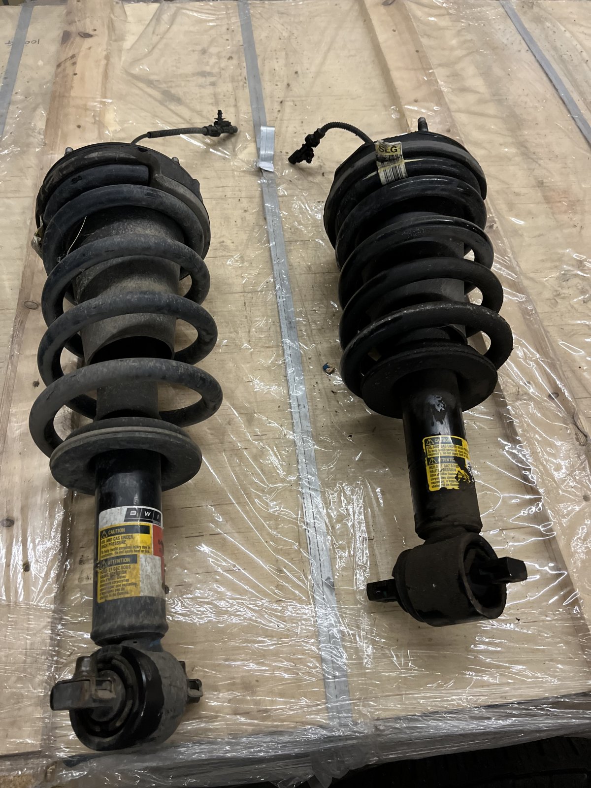

Ok, may have to surrender my on-line man-card but I did call a local dealer - same shocks as suspected.
And although we had two (out of 4 total between the two vehicles) that were obviously leaking, one was definitely the primary issue:
That’s about 2” give or take. Stuck like no other.
So while the issue was found, I’m not sure I’d pay to keep the Magneride system. In fact, I’m sure I will go classic and defeat the MRC system.
