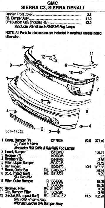

And a pic of some of the parts:

Well, no...you don't have to buy the fog lights, but your stock ones will not not fit. The filler is so you can't see behind the large gap between the grille and bumper cover, so if you don't care then you don't have to buy that either.
The impact bar is essentially the bumper. It is made for the Denali bumper cover and seems that it would be a lot easier than cutting up your stock bumper. I have no idea about putting a Denali bumper on top of a stock yukon bumper though.

Yeah, I would go with the impact bar. You will have to get different brackets too, I think. But if you can find this stuff used, it shouldn't be too bad ($$). Plus, you'll know it was done properly!
You do not have to buy Denali projectors. You can get regular Yukon projectors. The Denali came with projectors that had 9005 low beams (9006 was standard on regular Yukon). However, the Denali still used the same headlight harness, it just has a little jumper harness attached the the headlight housing to convert the plug from 9006-9005. I think most of the Yukon projectors that mimic the Denali housings have this jumper.

well from the pic it looks like theres 3 fillers i do need all 3 right?
