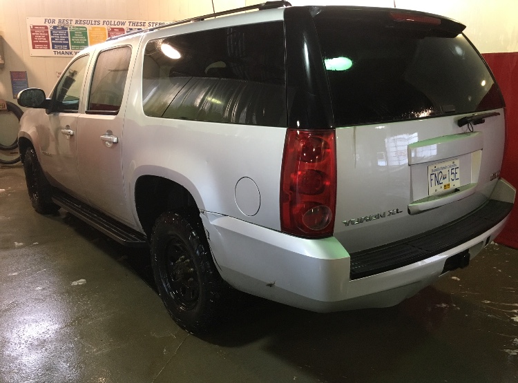

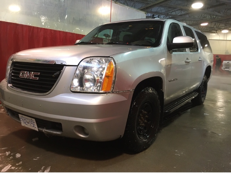

Only have a few pics so far, stuck working in the bush... but once I get back into civilization I’ll add more

Oh... I was also thinking about throwing a 2.5 level on the front to balance out the truck and airbag the back to make the ride a little more sufferable. She’s definitely a tank to drive. Then possibly adding some 33inch tires to fill the fenders. If anybody had pics of 2500 yukeys that are levelled, let’s see em!

It'll ride better with a couple hundred pounds added to the rear, get some lead or sandbags. Look around the forum for some fairly recent photos of leveled and lifted 2500s.
