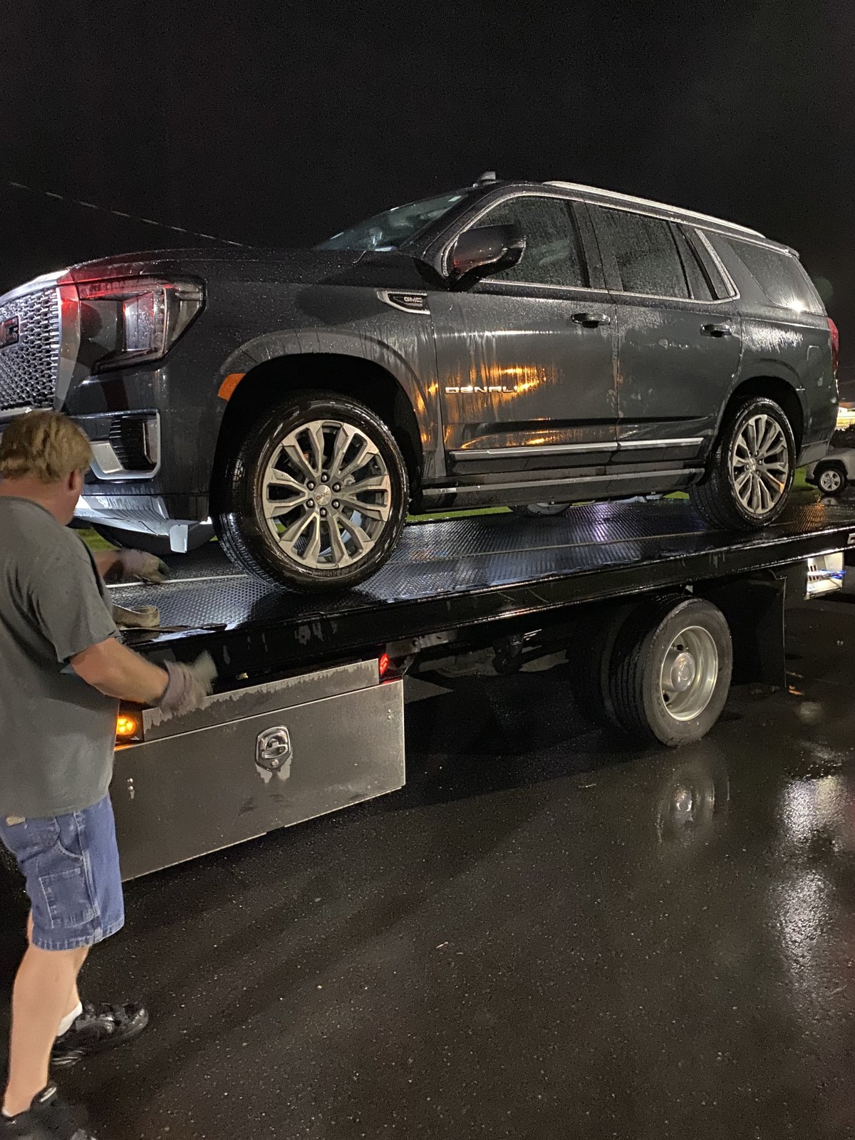

Just had it serviced yesterday, 5070 miles on it. We were headed on an 800 mile trip today, and it started to shake and knock about 144 miles into the trip. At a hotel, and headed back home tomorrow, trip cancelled. Getting a rental car, tow truck will be here in a couple hours to get it back to our home dealership.

Cylinder 2 lifters failed. Complete set for engine ordered. They're trying to get approval for replacing them all.
