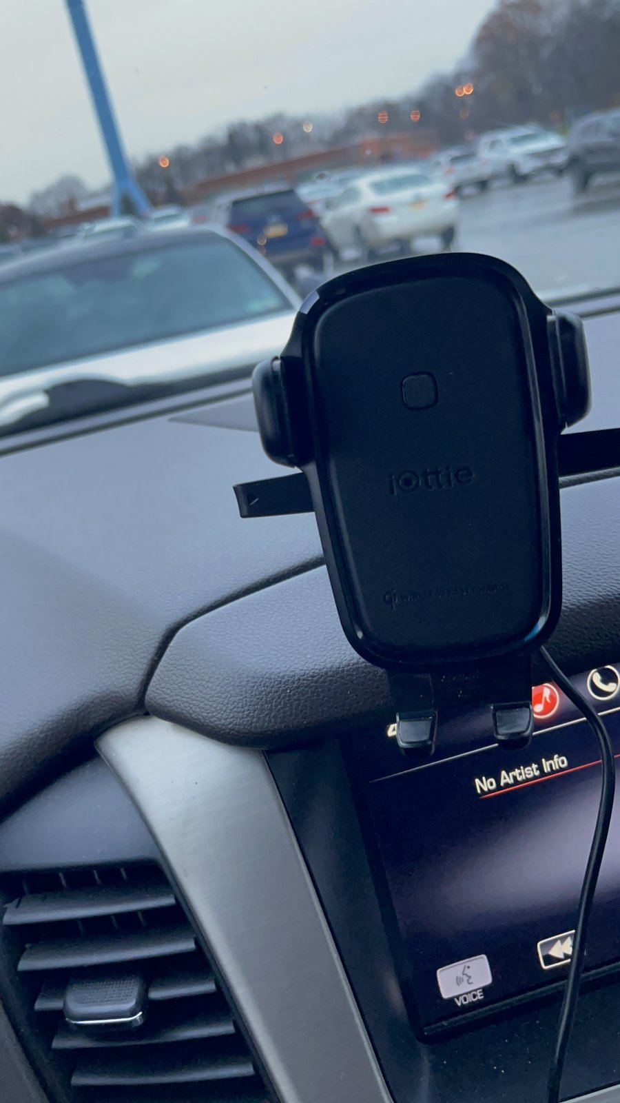

Totally off topic but those Iottie phone cradles are awesome. I have them installed in my fleet trucks.
