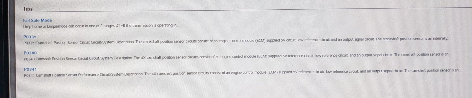

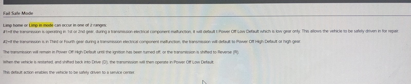

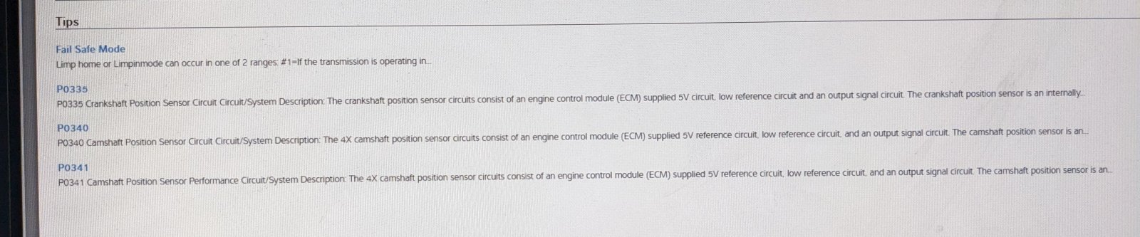

so I'll attach what my software says for limp mode for these trucks. I'm hoping you have one of these P code dtc's in your ecm. that would help give some direction as to why it's in limp.
and what the tranny defuals to when it's in limp mode.
hopefully those arw readable. I'm just on my phone and can't tell on my end.
