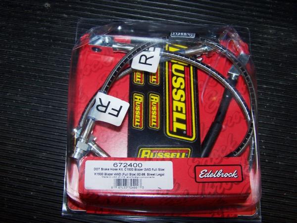

YAY! My SS brake lines arrived Today! What fluid should I buy?

Well that sucks, they changed their packaging. I didn't get any Russell stickers =(
