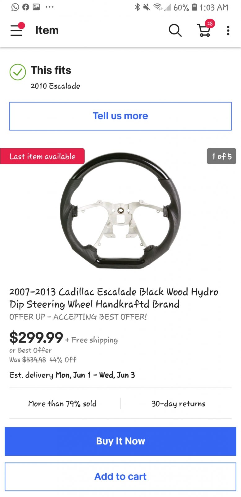

Might be time for another steering wheel of you don't mind losing your heated steering.
That looks nice!
I ended up replacing my steering wheel with a GM non-wood one. It had all the buttons and heat that my original one did. But I think these are no longer available new. I'd given up, until I ran across someone else's post about a supplier getting a shipment of 3 in. I quickly snapped up one of those, and haven't heard of any more.
So now, the one you've posted might be the best new option, unfortunately without heat. Aside from that, you could possibly find a used one that came without the wood, and have it recovered.
