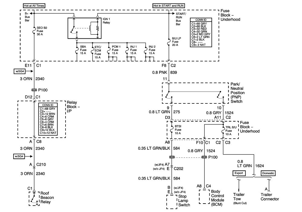

OK now things are starting to make some sense here. Your PCM 1 fuse ONLY gets 12v when you are in Run and STart position with your key via the ignition switch. The actual electrical ignition switch which is down low and right side of your steering column shroud provides that 12v to your PCM 1 fuse. Without 12v to that fuse which ultimately ends up at your PCM as what appears to be a input signal (Not actually powering the PCM itself). You can see this on the attached schematic for your 04 Yukon. You are going to have to put a voltmeter on the PCM 1 fuse while someone is cranking the engine and see if 12v is there. Check your PCM B 20a fuse which should be hot all the time.

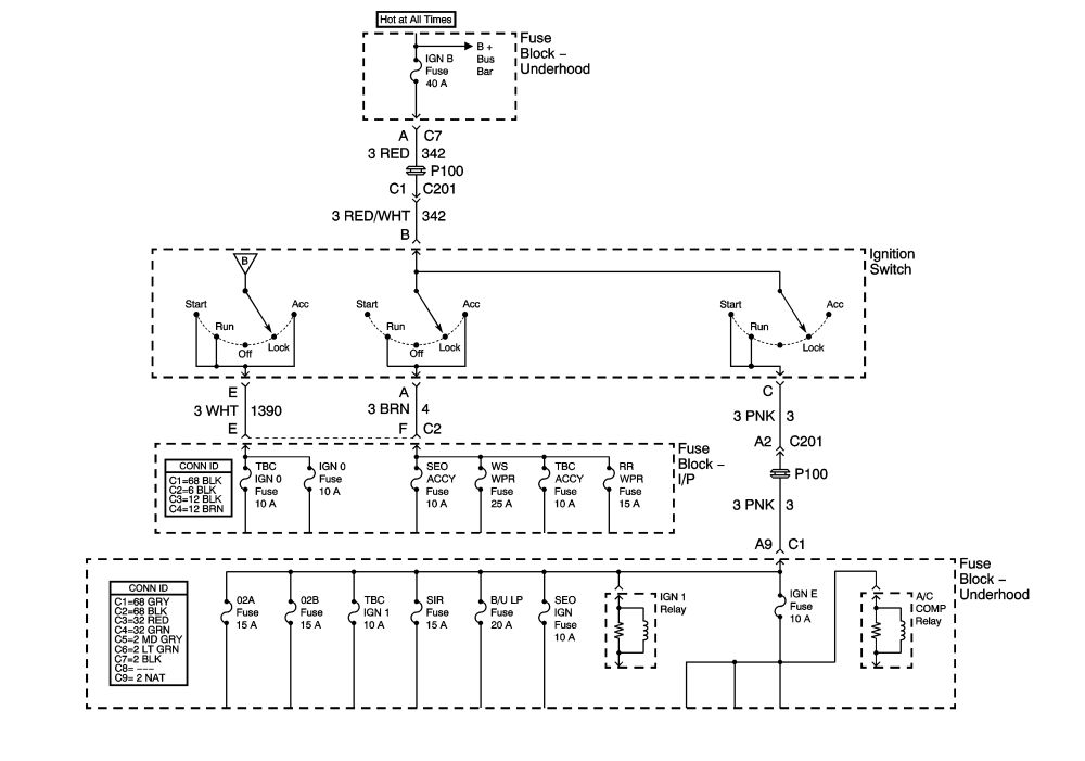

1.1v at PCM1 aint gonna cut it. Thats a problem. So there should be battery voltage there when cranking and its source is IGN B 40a fuse (Hot all the time) then it goes to your ignition switch and out terminal C (Pink wire) when in start or run position then to your IGN 1 relay (THE COIL of it), NOT the contacts. Now PCM 1 fuse gets its power from the contact closure of IGN 1 relay. The question here is do you have a control problem (Coil relay) or an actual power problem (Coil contacts) and since you are hearing what sounds to be IGN 1 relay clicking but then reading 1.1v at the PCM1 fuse which got through the contacts of IGN 1 relay, I would check for good solid battery voltage at the relay coil while ignition is in the start or run position first. You will have to pull relay and measure at the socket. It will be the 2 smaller terminals of the relay. One will be ground and the other 12v+ when ignition is in start or run position.
Since you already replaced the ignition relay as mentioned in the first post I suspect you have burnt contacts in your ignition switch OR a bad associated ground for your coil in the ignition relay or the green crusties underneath the fuse box and its corroding something associated but its entirely possible that you have 2 problems and one is the control side and the other is in the power side.
You could just jumper the 2 bigger terminals of the ignition relay socket while someone is cranking engine and that could help rule out the power side of the ignition relay.

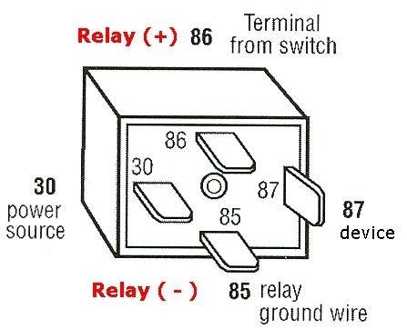

Ok I pulled the relay, IGN 1 I'm measuring voltage at the sockets like you said but I'll give you the pin numbers of the relay. This is in run position. Pin 30 reads 11.5v pin 86 also has a reading of 11.5v. I'm not sure if this matters at all but I figured I'd let you know just to be sure. I also checked the socket of pin 58 and 87. Pin 58 had a reading of 328mv which I felt was worth mentioning. Pin 87 had a reading of 24mv. I did a key cycle and checked again. I got 164mv at pin 58. Like I said I'm not sure if that matters or not. I did pull the fuse block, and I carefully took it apart a couple days ago. There is no corrosion anywhere in it.

Terminal Pinout Ignition Coil
86 (Relay coil +)
85 (relay coil -)
30 Power source for load
87 Device (load)
Firstly your 11.5v readings should be well above 12v, along the lines of 12.6v + so charge that battery. Low battery could cause your ignition relay to chatter. Terminals 85 and 87 will read 0v since terminal 85 is ground and 87 because you are holding the relay in your hand which passes 12v to it when relay is energized closed. So do a resistance measurement to ground from terminal 85 to verify it has a good ground. Once battery is charged up, test PCM1 fuse for 12v with someone cranking engine over. If good then you could have a broken wire between fuse block PCM1 and PCM C1 Plug or you could have something going on at the PCM C1 plug at the PCM terminal 19 Pink Wire. Inspect for rodent damage, corrosion or pushed/broken/corroded terminal within C1 plug.
