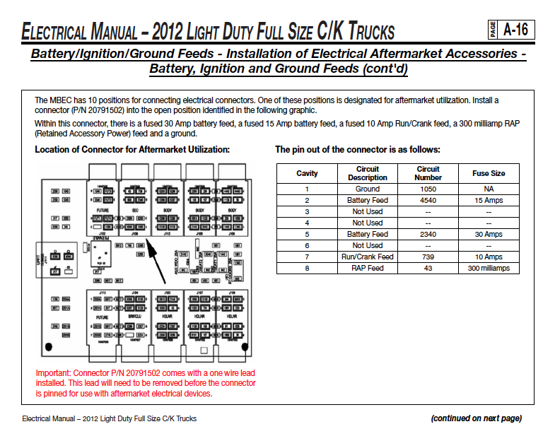

Hey, I'm wondering if anyone's got a wiring diagram or a diagram period of upfitter box underneath the dash.
