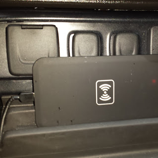

I made my own out of the stock insert, works great.

Could you provide a bit more info as to how you did this? Which model did you use? Could we get some pics?

Forgive my poor write up skillz.
I bought this:
http://www.amazon.com/Bessky-TM-Wireless-Transmitter-Charging/dp/B00MUV5DHW/ref=sr_1_110?s=automotive&ie=UTF8&qid=1409696562&sr=1-110&keywords=qi+charger+galaxy+s4
Hacked it up and silicone to bottom of console insert thusly:
Drill through console lid, run power wire, reassemble, enjoy!
Second unit for the wife's phone.

Awesome write up actually! I'm definitely doing this during the weekend. How easy is it to take out the plastic top?

6 torx screws, use a putty knife to pry off coil, don't lift it, just shove it in between plastic and coil. BTW, this wont work on thicker cell phone cases (Seido, Lifeproof, Otterbox etc.), I use a thin case and it works well for me.

Do you have any issue with the power going through the plastic? I currently have a case on my phone but have the wireless charging. Do you think I'll have to ditch the case?

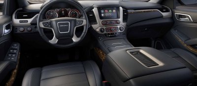

GMC has updated their website and posted a picture of the wireless charging pad on the armrest.
