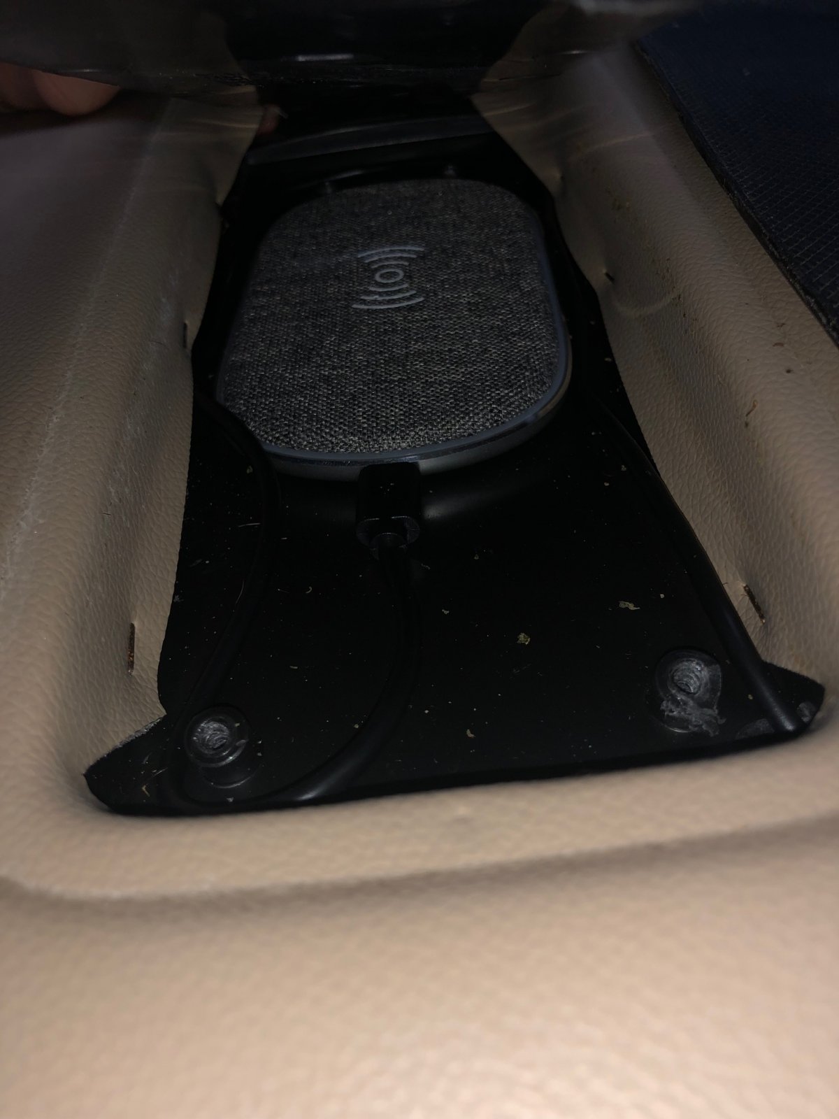

Yes I have done what I think your explaining. I bought a fast charging wireless pad with pretty good range and I installed it underneath the hard plastic that is underneath the rubber pad in the bottom of the tray you speak of. I don't remember the exact charger I bought but I can get a 25% charge in an hour trip. Which I think is pretty good considering its charging through a layer of hard plastic, layer of rubber, and the case on my phone! I thought about looking into a charger that are meant to go through thicker cases so that I could maybe get it to charge a little faster.
It pretty easy to take the lid apart to get an idea how much space is there for a charger. I didn't even tear my charger apart or use any adhesives. When I screwed in the plastic piece that makes the try in the lid it holds the charger in underneath it tight. I try to remember to take some pictures of mine this evening.

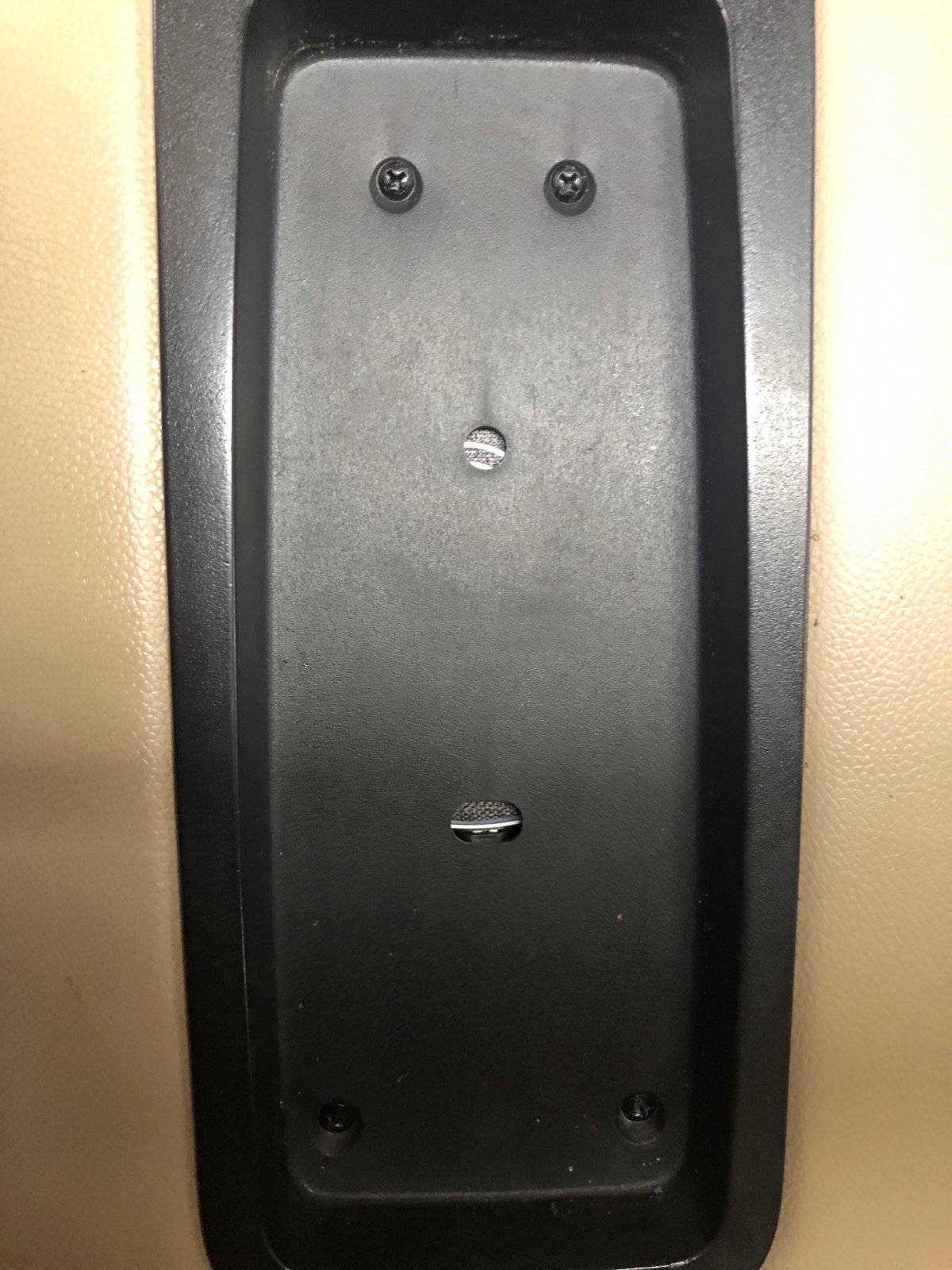

have any pics of it installed? did you go under or above the rubber pad? what input did you plug it into, the usb inside the console or did you use an adapter for cigarette power port?

Sorry took a while but there it is... the wire goes under the rubber towards the back where I drilled a hole for the USB connector to go inside the console and plug into the outlet

Well sorry for taking so long @Moose912 but I got some pictures. I didn't take pictures of underside on console lid opened up. But it was pretty easy to run wire through lid and to 12v plug inside console. Im sure it would be easy to hard wire charger rather than use the plug if you wanted to leave the plug open. There's a picture of the charger I used too. Got it off amazon and it was highly rated.. it works great. But I had wanted to look around for a charger that's meant to go through a super thick case but haven't gotten around to it cuz this one has been working well. Hope this helps
