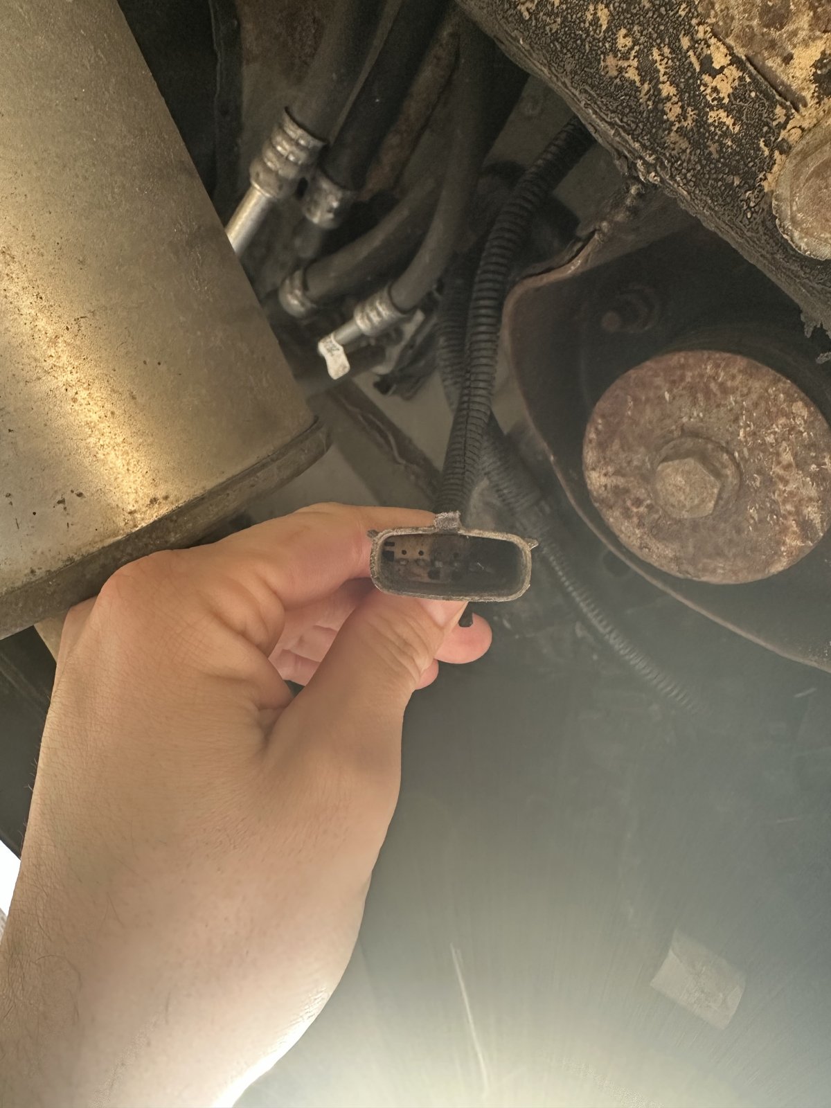

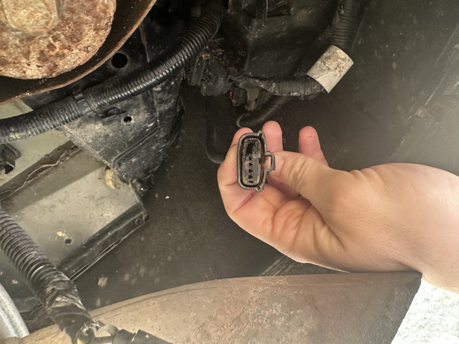

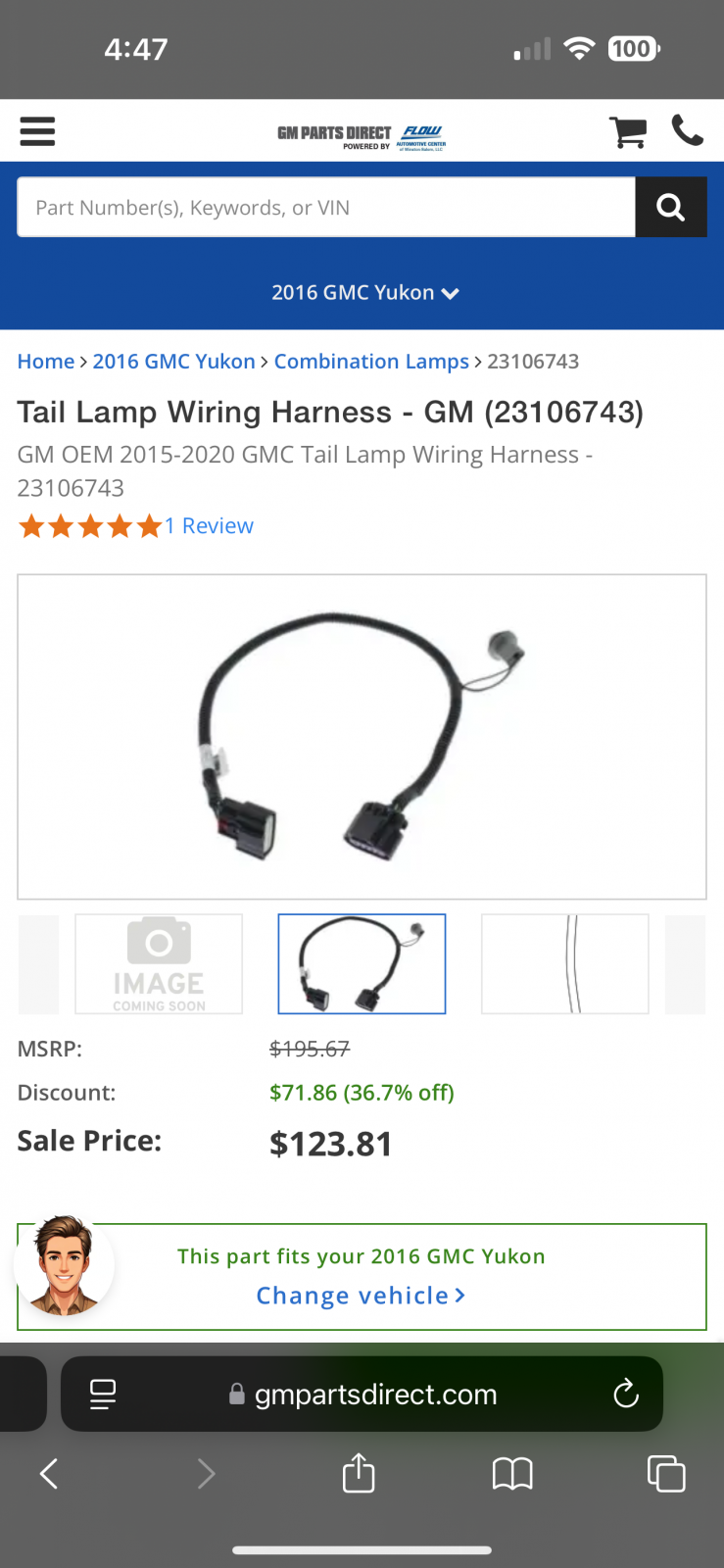

Here is the picture of the harness I’m looking for. I can only find the tail light wire harness that fits directly into the back of the oem led tail light on gmparts. I need the harness that is in the picture that goes up behind the spare tire. I can’t find that on the website.
The first 2 pictures are of the wire I need. It plugs into the tail light harness and it goes up behind the spare tire.
The 3rd and 4th pictures are of the actual tail light wire which I’ll be ordering as well.

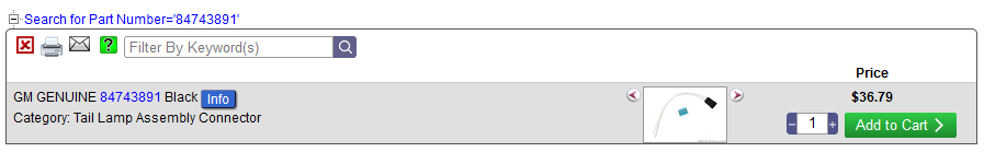

That harness is part of the chassis harness, but you can get the mating connector to repair it.
GM#84743891
$89.99

Appreciate that. I’ve found it, but since it’s not a replacement harness, is it somewhat easy to repair it? For a non professional
