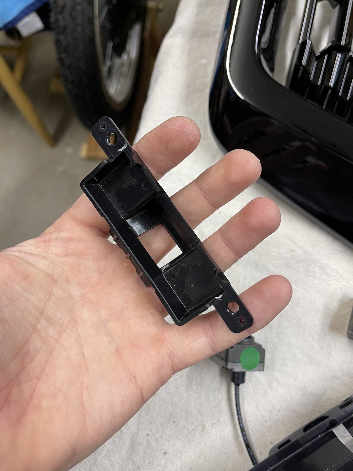

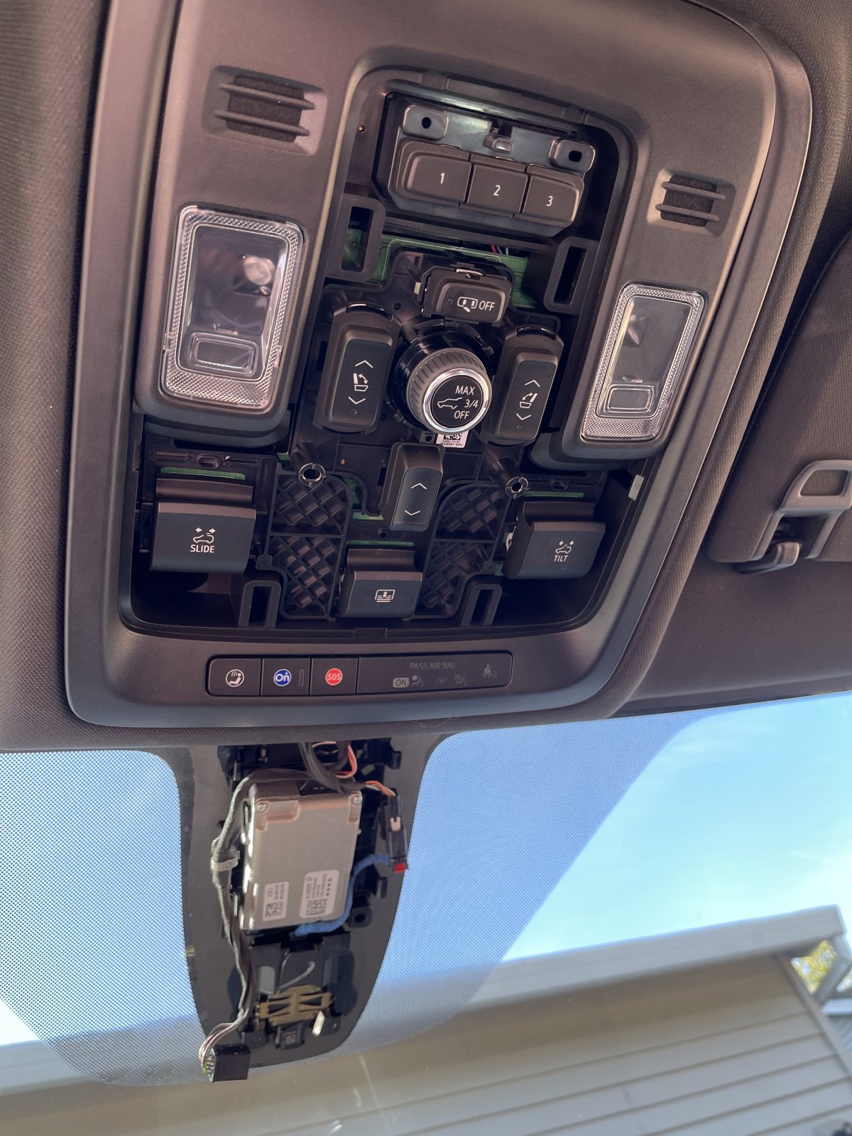

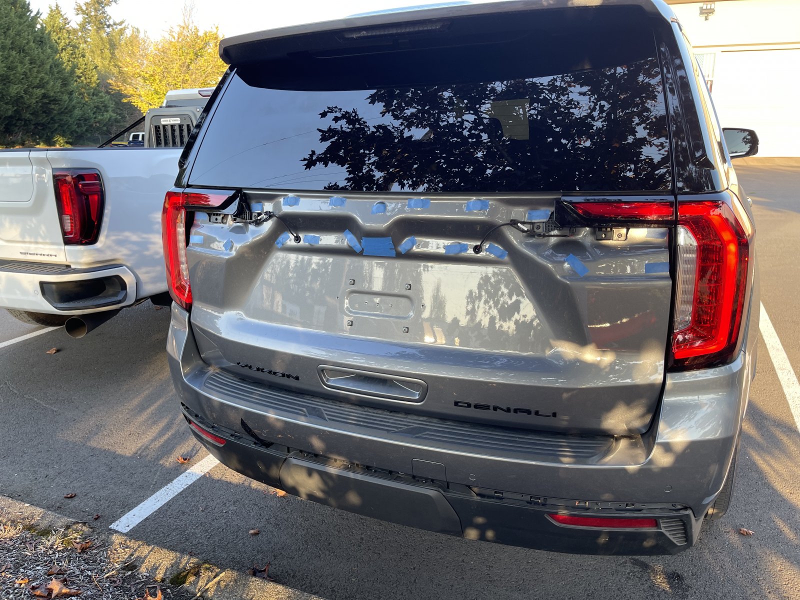

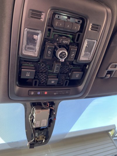

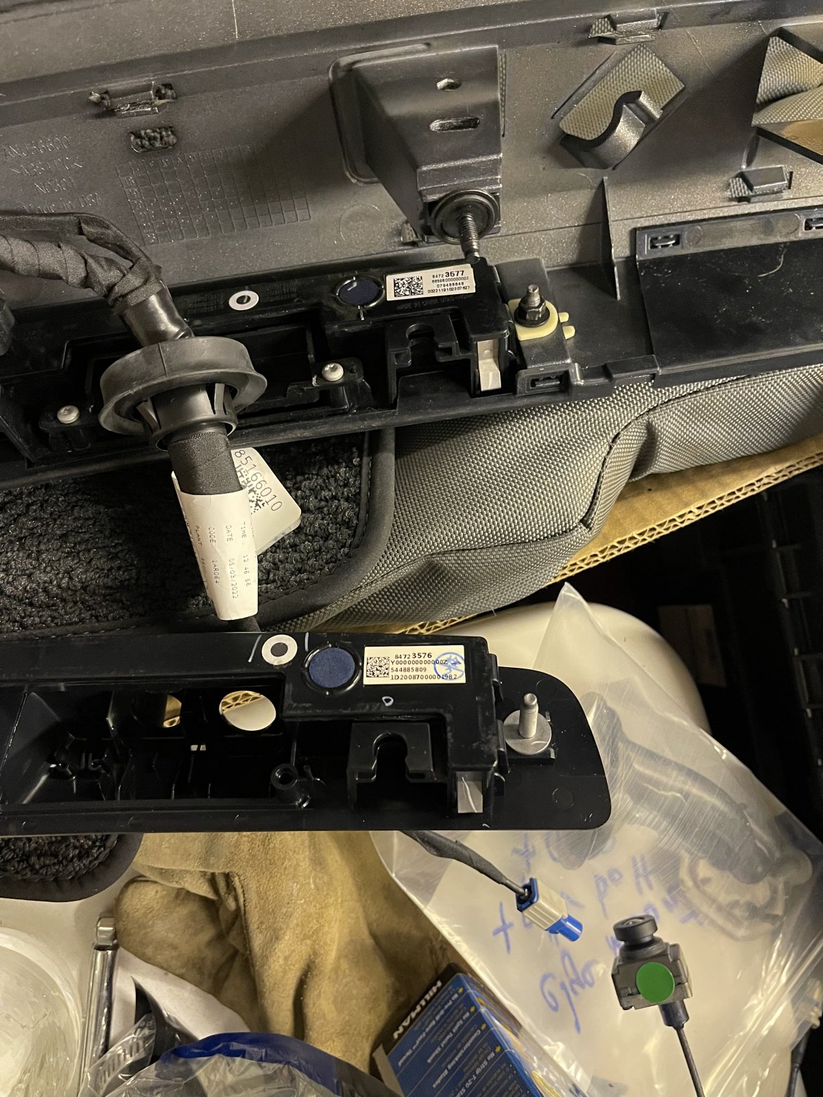

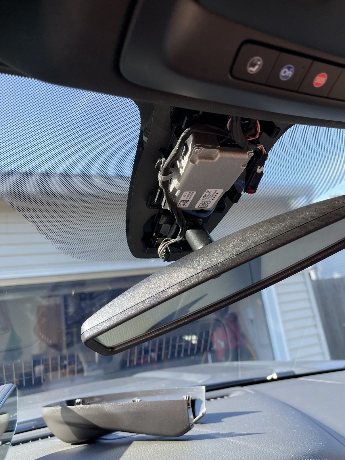

I’m doing it right now but I’m hung up on one part. I bought the rear lamp assembly where the cameras go, but it didn’t come with the bracket that secures the cameras in place. I’m not sure if that’s in error or not. My old bracket on the old housing doesn’t have a part number on it.
The dual camera bracket also has a hole for a washer fluid nozzle which sprays the camera (wish my 21 Sierra HD had that nozzle). I haven’t ordered the hoses yet. It’s not 100% clear to me which hoses I need but they’re all pretty cheap so I’ll just get them all.
Getting the panels off the lift gate was not a small undertaking. I’d say if you aren’t experienced with that sort of thing I’d maybe say to think twice, or find a buddy who is. The whole rear exterior piece has to come off. Similar sentiments regarding the headliner; it’s not hard to simply tuck the cables but I like to tie them up and away from the airbags; the headliner is fragile, and the pillar trim pieces are soft and scratch easily.
