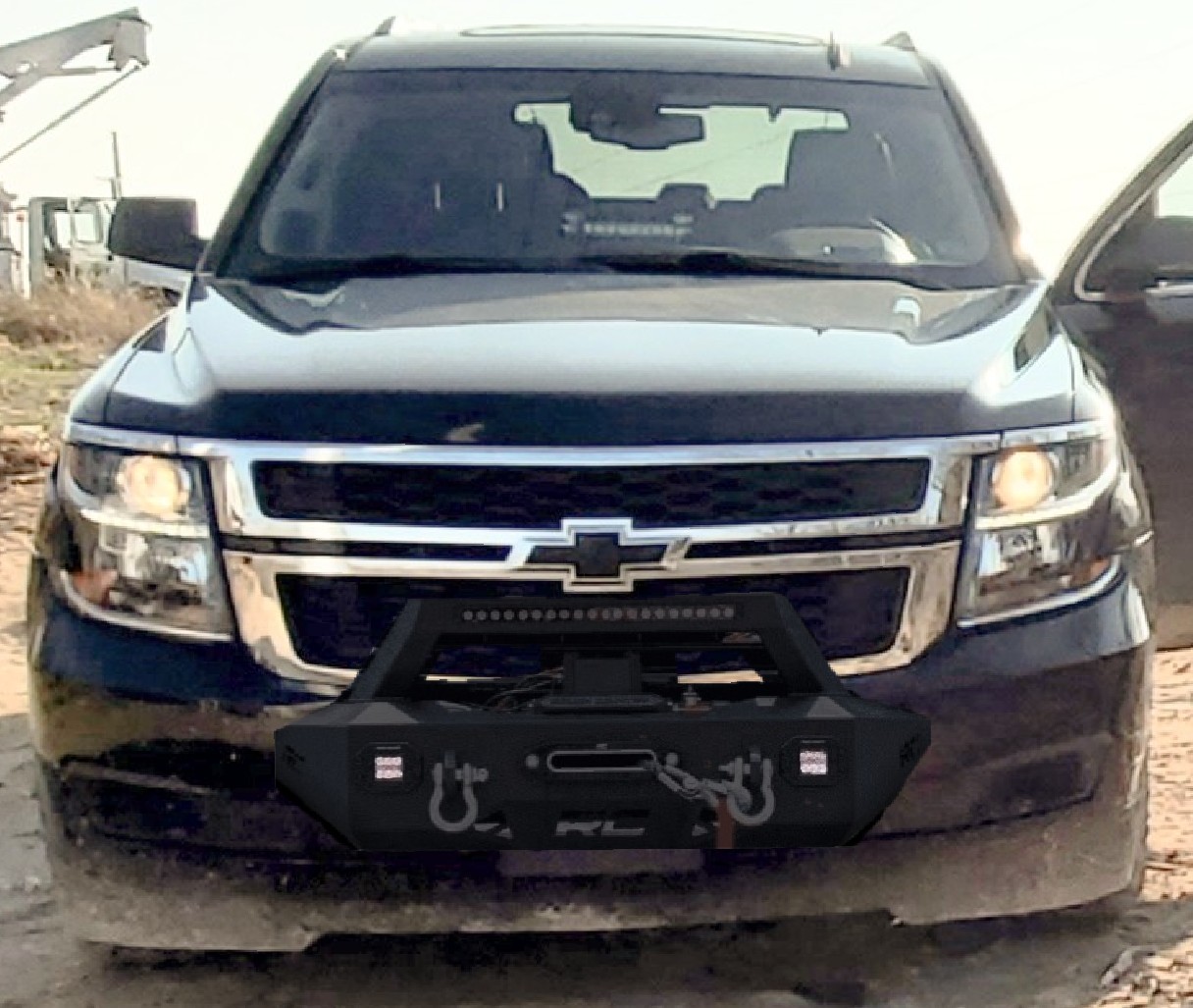

I'm leaning toward adding the bracket to the Elite XD pushbar, or modifying a Rough Country EXO winch mount to work. Please excuse my horrible photo shop skills of the EXO attached. I have pretty much found nothing online for the 15+. Google searches have shown very little. Westin doesn't even have a picture of their Max Winch system installed on a Tahoe.

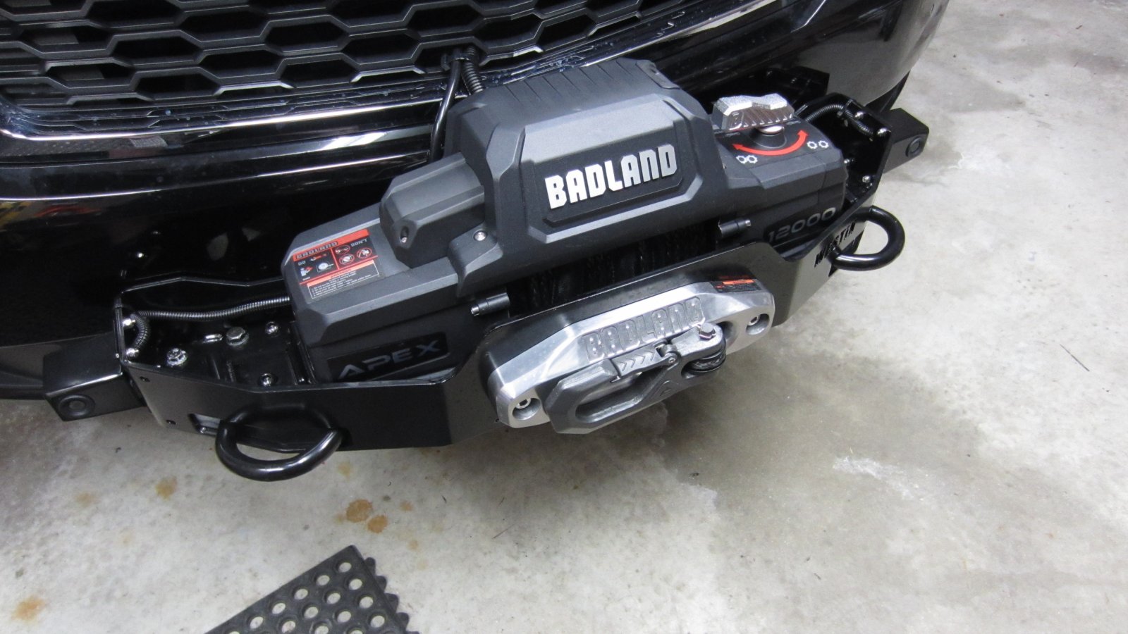

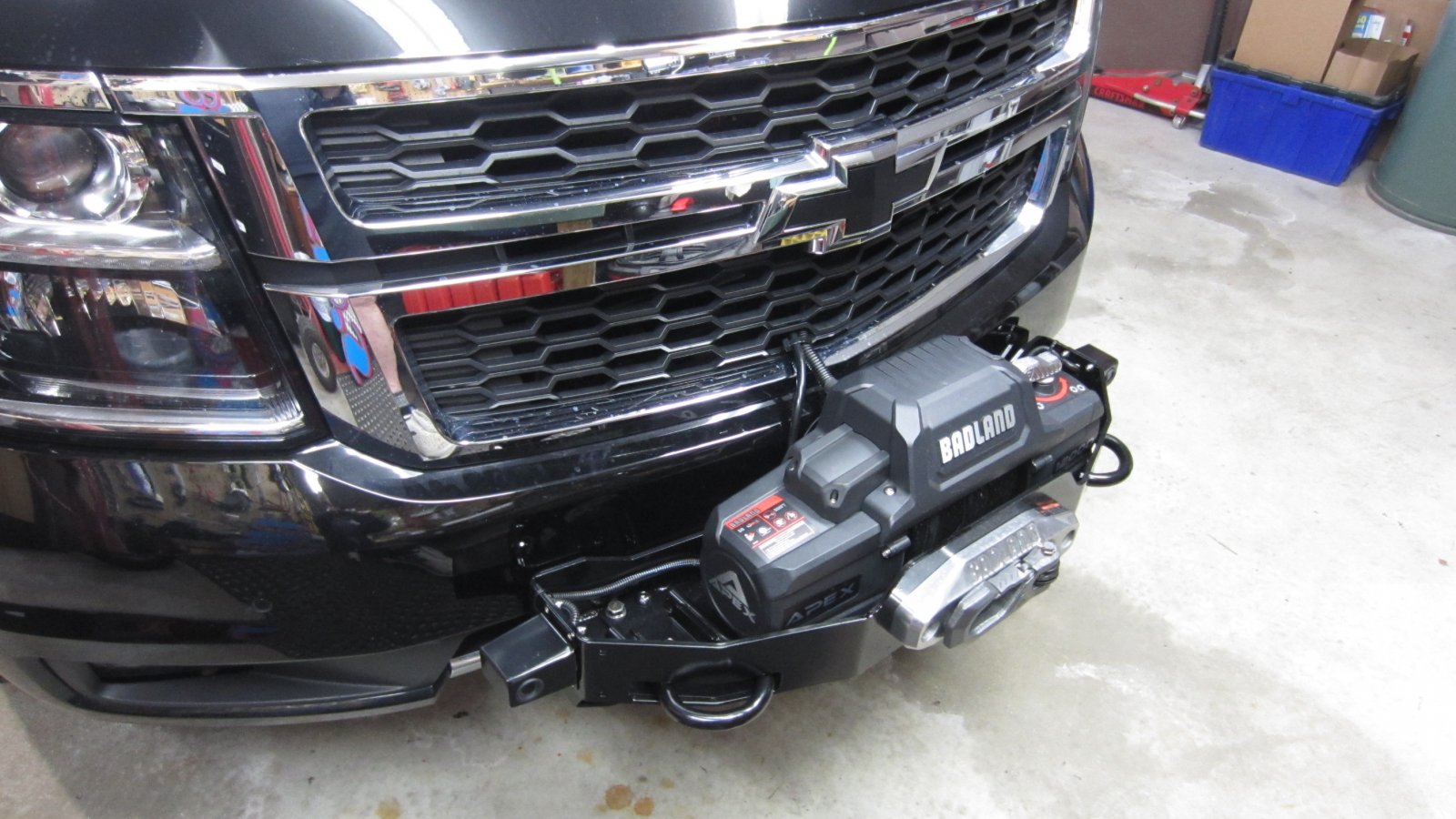

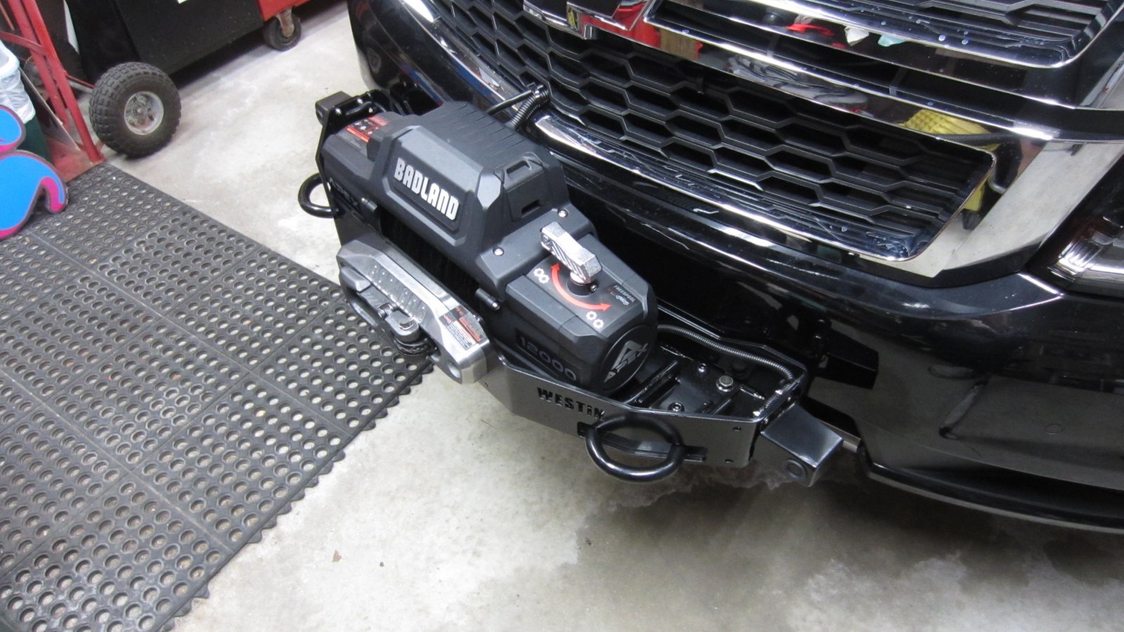

Not a PPV, but just installed a winch on my 2020 Z71 Midnight Edition. Went with the Westin Max Winch Tray, along with their Tow Hooks (You will lose your stock Tow Hooks), and the Parking Sensor Relocation Kit.
