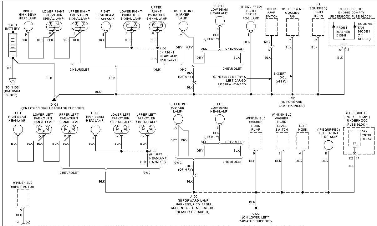

Header on ground wire somewhere or neg from battery, def a ground or neg cable somewhere
It's very odd, the only wire I can think they would have removed to do the headers would be on the passenger side starter with.
When it was at idle and I did the same thing with the windows it did nothing much and it stayed running and did not dip in rpm.
I'll check all grounds when I get home today .

The grounds I can think off the top of my head are passenger side battery to block, driver's side to block in from of alternator , ground strap on driver side head in the back and under driver's door in the frame and batter ground cable .

So I just went out in the day light now , it was 4am when I went to work, both the driver's side positive and negative are loose on the battery . Not really that bad but now that I can see both turn easy on the both posts with out much effort.
There are 2 on the 2 frame rails almost under the rad support really need to remove front bumper to see them.
Nevertheless i see you found your problem. Good luck
