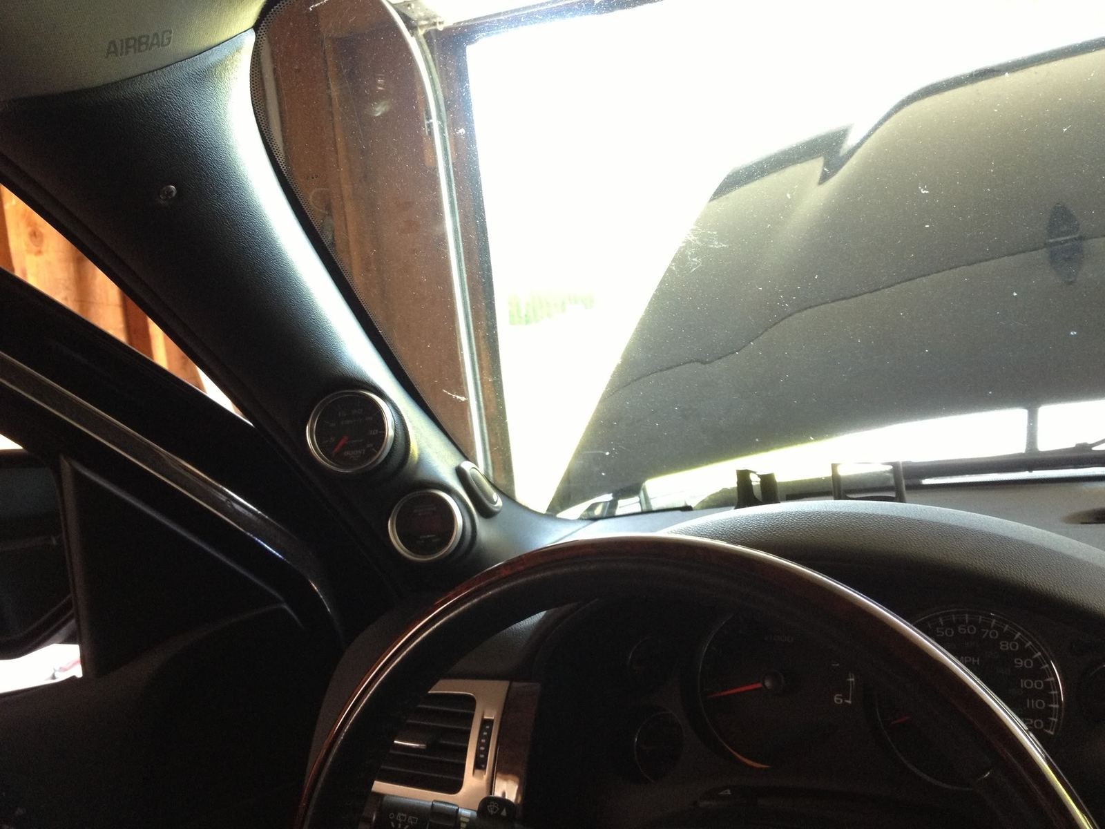

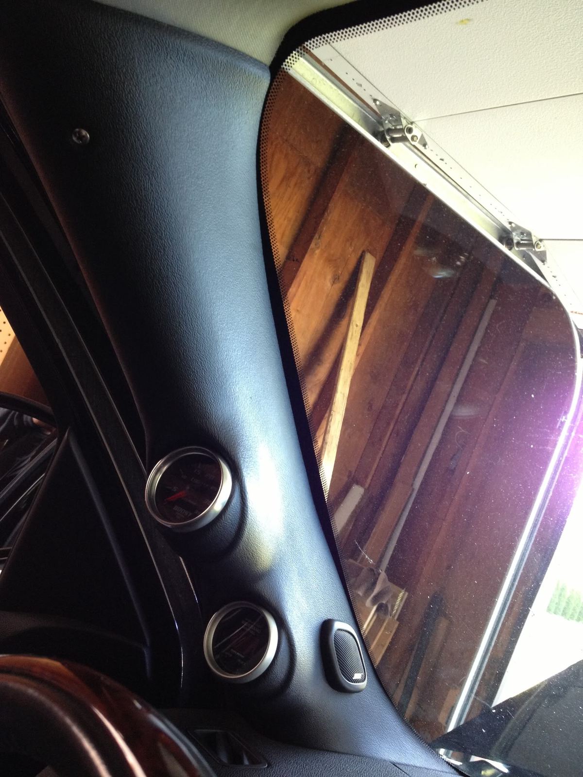

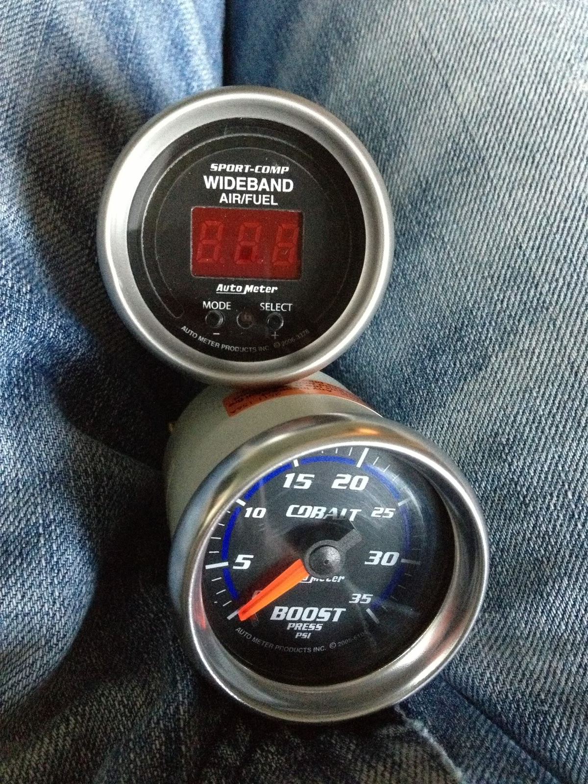

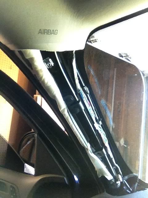

So finally got around to getting some gauges for the Yukon from my neighbor. Autometer stuff...not same model, they were a gift so im not complaining...got the pod from summit, autometer pn 17117...

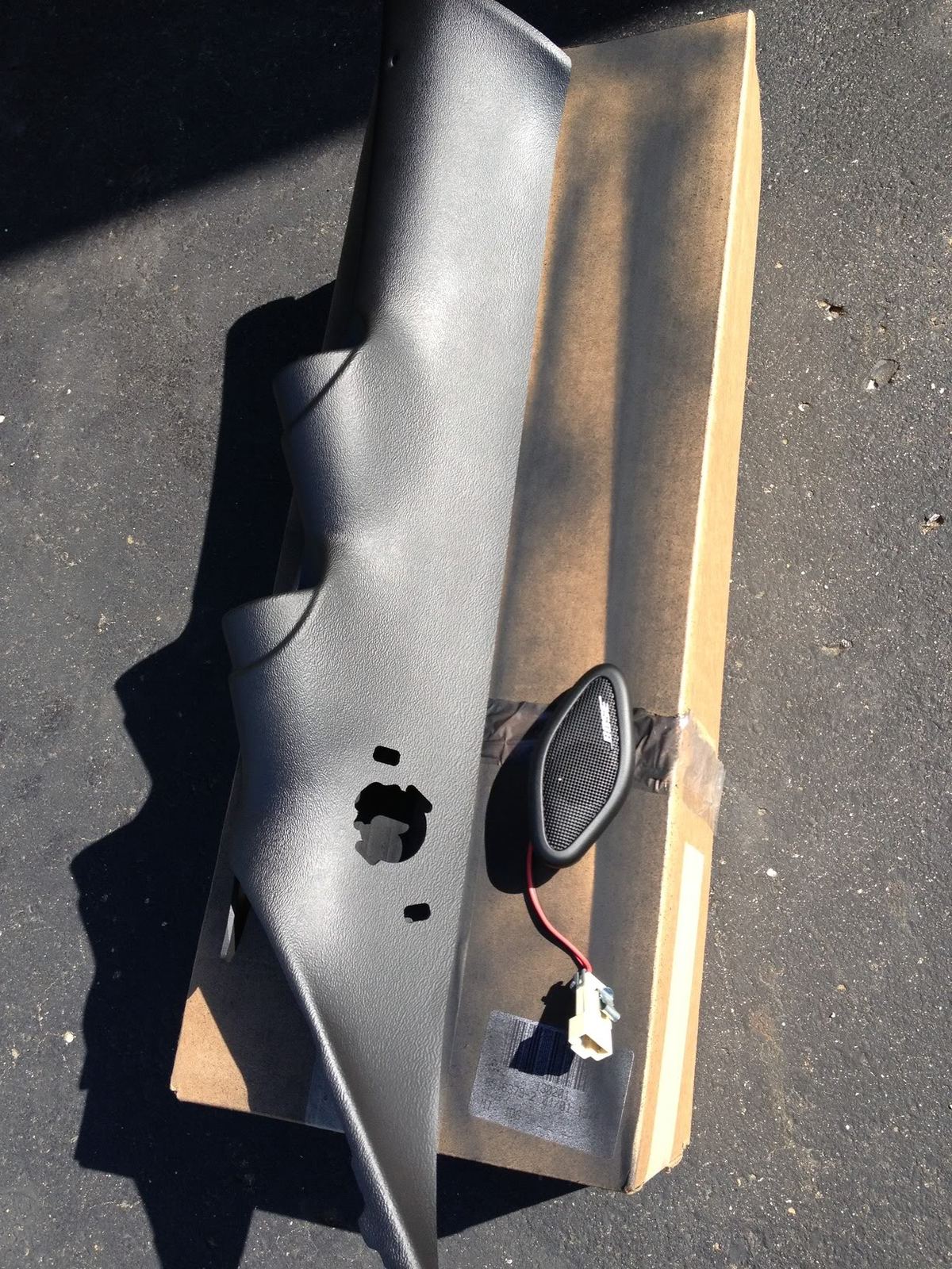

After some debating, I decided to paint all pods black as im not a fan of the greyish roof and pillars...

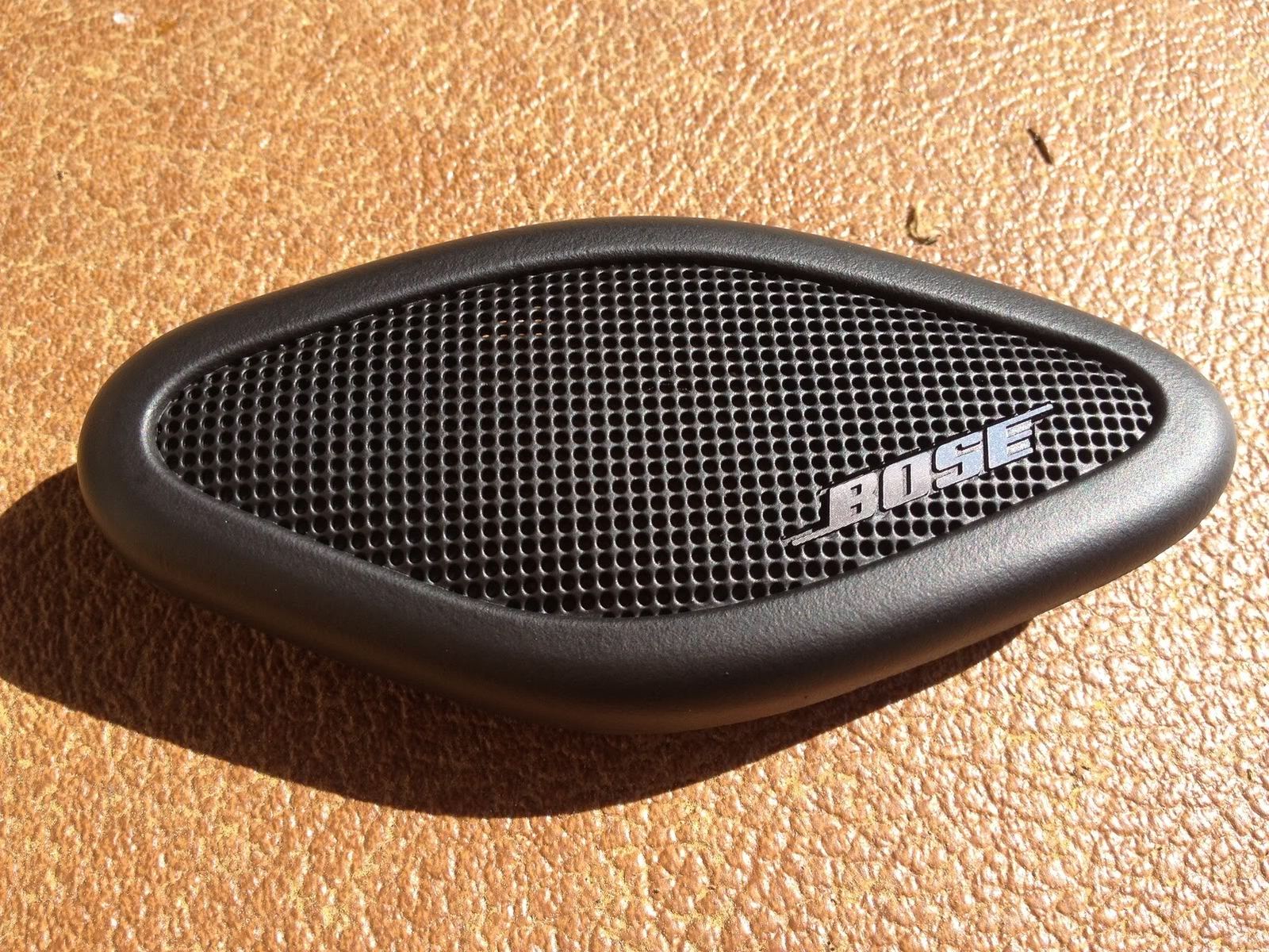

To match the pillar, i had to take the Bose speakers apart. Have to be careful so you dont snap the staple style Bose logo, but its pretty straight forward to take off.

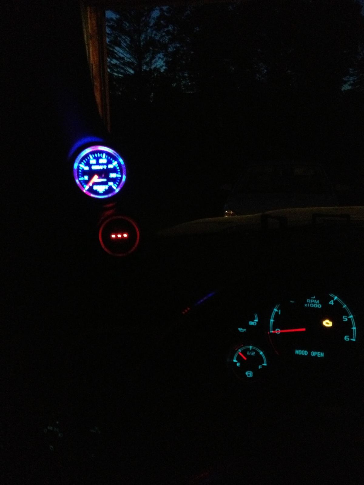

This is an LED thru the dial gauge, so i believe i have to buy a LED dimmer for it to get it to dim down...in my other car, the boost gauge is a standard bulb and it dims just like the dash lights dim, but not sure how its going to work on this application.
Right now, I have it hooked up to an ignition hot fuse under the hood...so it lights up when the key is on...

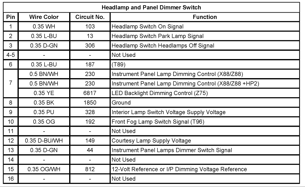

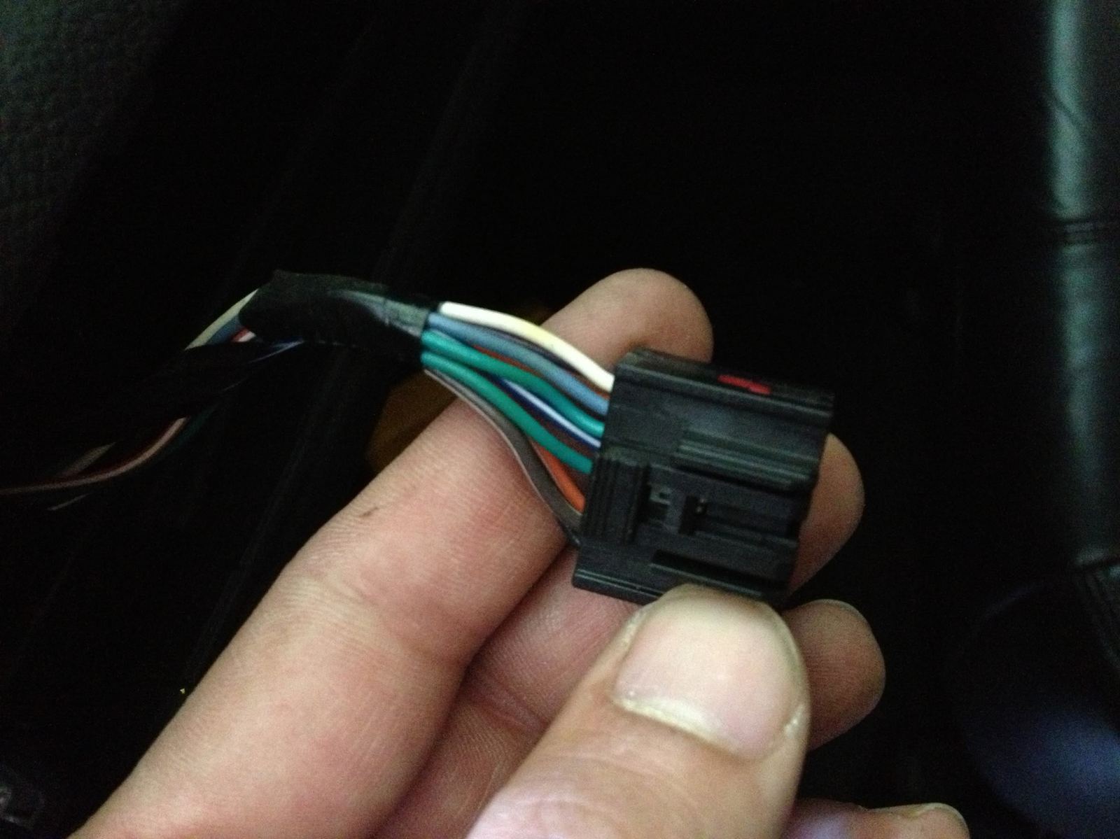

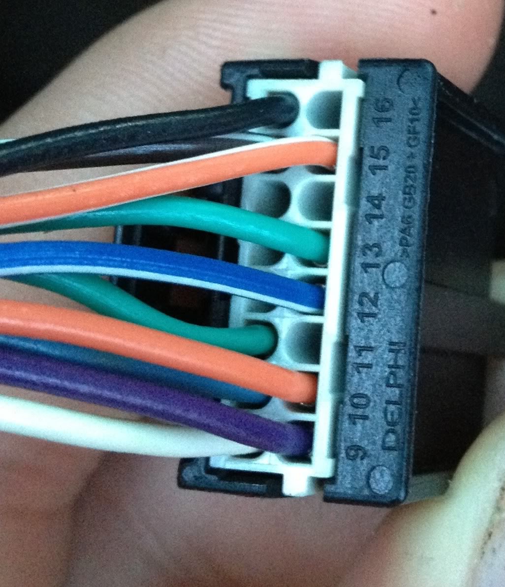

can someone help me find a wire i can tap into that is on when the lights are on? would it be behind my dimmer switch in the dash?

I run the Cobalt series gauges in my HD and Suburban in both trucks I added a resistor in line to knock some of the brightness out of them. Now they are damn near the same brightness as my stock gauges. As far as the dimmer wire, it is in that harness, I honestly forget the color I used, the panel pops out easy enough I'll try to check later or tomorrow.

Sounds good...from the breakdown i got, i believe its the "brown/white" pin #7 wire...if you can double check...that would be awesome...

Here is the harness diagram

Ran the gauge with the 1000ohm resistor...slightly less brighter than the stock gauge dimming IMO, might try something smaller...regardless, its pretty close tho! thanks for the tip!!!

Tried a 560 ohm resistor last night...i think its lil closer to my taste of dimming and matching the stock bulbs.
