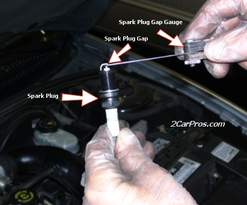

What exactly do you mean by re gap? Do I actually pull out a ruler and measure some gap somewhere on the spark plugs?
no you go buy a spark plug gapping tool for a buck or two from your local auto store.... it is a circular tool that will tell you what the gap is and it has a hole at the top of the tool that will allow you to open the gap up. if you need to close the gap up (like in this case) then you can just push it down on any hard flat surface
