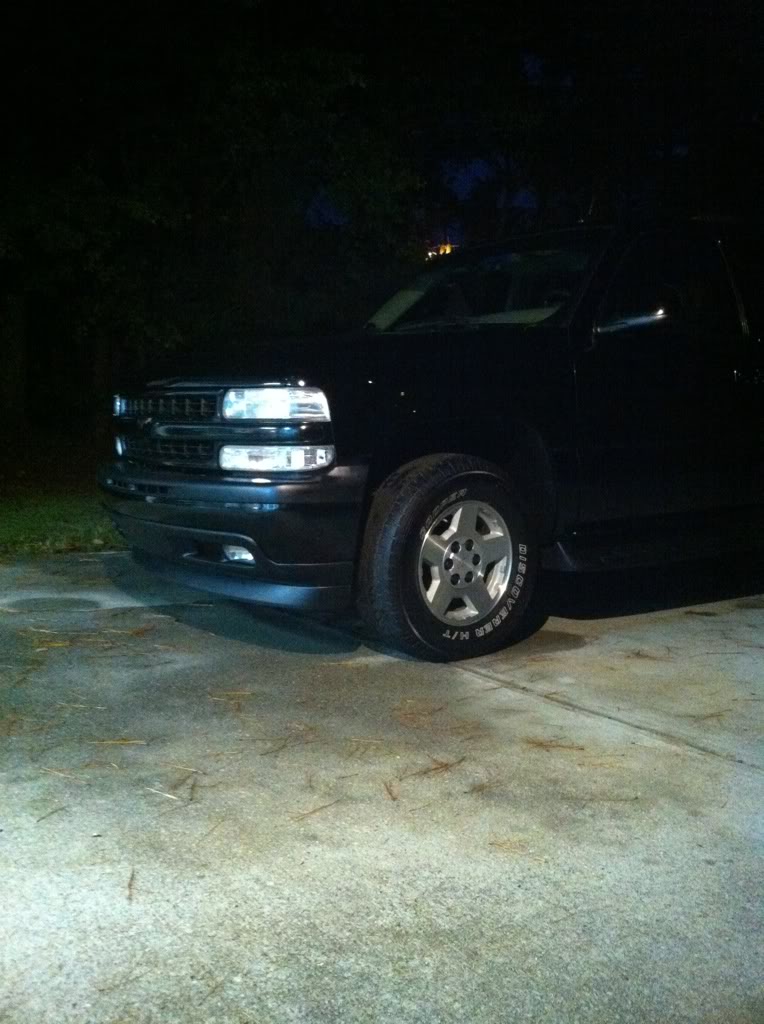

heres the front...they came out really good. the guy charged me $170 and thats with the cost of ordering the powder
bottomline2000
Oct 21, 2009
1,722
991
Dallas, TX
That looks good, just like paint. We have psyho soccer moms with minivans of death around here so this makes keeping the stock bumpers much more appealing. Can

Wow. That looks really good. A lot more reflective than I thought. Definitely going to have to look into doing this.

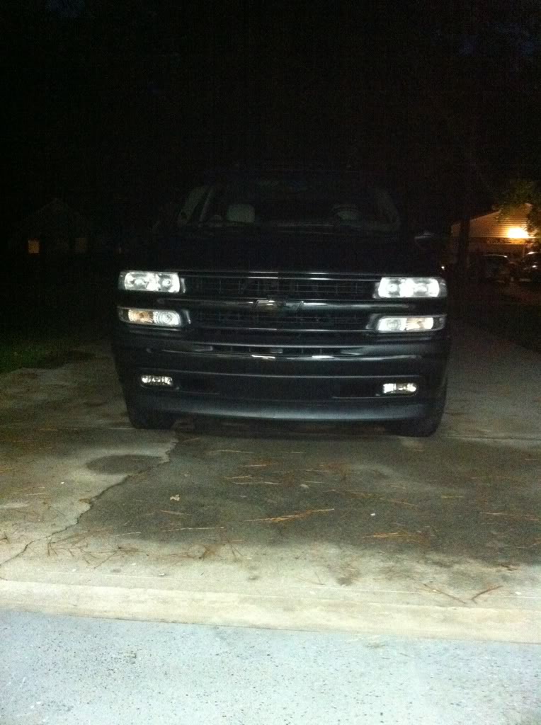

you dont paint the powder...you can get almost any color powder you can think of. the common colors (black, white, silver) are the easiest to match. i painted the grill, the upper cap, and bottom valence black to match.
i also bought that lower extension from the dealer for 35 bucks and painted it as well. i love the look. i had the SS bumper on there before but wanted a more stock look. this fits the bill.
